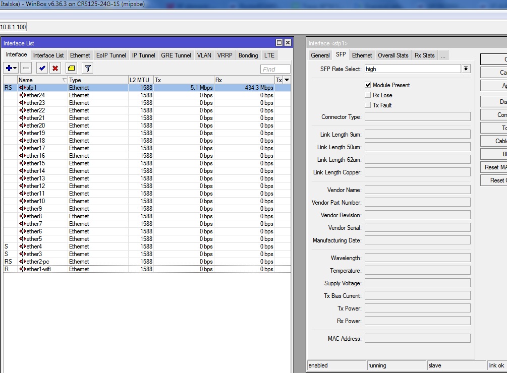

I just got 2 GPON ONU module but when put into MikroTik routers they seems that are not detecting SFP modul details (funny is same at both) but say “Modul Present”. RouterOS is 6.36.3 (tested also on 6.33.3).
Is it possible that are both modules broken or there are any details that I forgot?
Subquestion: I think it should work if “SFP-Modul SFP GbE-BX10-D” is on ISP site? OR? (cos I don’t recieve no data)
Thanks for any tips…

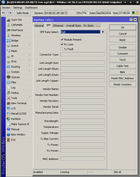

My GPON ONU works well, but also show no details in CRS125. Do you have someone working GPON SFP with details about SFP module? Thanks
