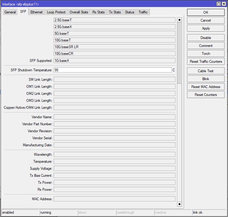

i also own a SFPONU but under the SFP-Tab there is no information at all. Also i can not get a link between Mikrotik and ONU. But ISP is seeing my GPON-Stick and is able to do internal diagnostics. So it seems that the issue is only between SFP and Mikrotik.
Using CCR2004-1G-12S+2XS with v7.18.2
Is there any solution for that?
ONU is alive because it is getting power from MT router through SFP/SFP+ port. But as you deducted by yourself, support in ROS is missing. There’s no immediate solution to that, the path towards solution is to open ticket with support (e.g. via e-mail address support@mikrotik.com). And I’m pretty sure that they’ll want supout.rif file, taken while ONU is plugged in, so you can attach it to ticket opening action (e.g. e-mail) as well. But don’t hold your breath for a solution, they might decide not to bother.

Funny , I was just playing around with my last-remaining still-working Mikrotik GPON SFP module. And although it still works , there is nothing shat shows up on the SFP tab.
However , a FS GPON module does show up in the GPON tab.
Re my post :
Later in the day after I posted the above message …
I was doing some test configurations with a FS ( GPON on a stick SFP module ) and I pulled out my last remaining still-working now discontinued Mikrotik GPON SFP module. The two GPON SFP modules do the same thing and use identical configurations , except the Mikrotik GPON SFP module never showed any SFP information in the SFP Winbox tab. Note - the FS GPON SFP module showed everything in the Winbox SFP tab.
So, although the Mikrotik GPON module was still working and talking on my GPON network , I decided to upgrade my Mikrotik router from a version 6.something to the latest version 7 ( big mistake :frowning: ).
It appears that the latest Mikrotik ROS version 7 does not recognize or work with a Mikrotik GPON SFP module. ((( WTF - a Mikrotik router does not reconize a Mikrotik SFP device !!! - WTF ))).
The semi good news is that the Mikrotik ROS ver 7.18.2 does work well with the FS GPON on a stick SFP module.
