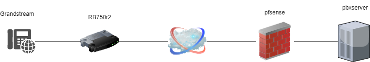

I have a grandstream device connected with the mikrotik rb750r2 then the web, a pfsense and the pbx server.
Between grandstream and mikrotik apart from connection there is also a openvpn connection.
Between mikrotik and pfsense there is a openvpn connections.
All traffic should be only on openvpn connections and without nat. Pbx server could connect to the grandstream device with its ip at the openvpn network.

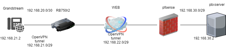

the ip ranges i have given above were wrong
new diagram.

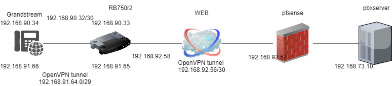

One other point, from the diagram, it appears that the Grandstream and the Mikrotik are on the same subnet/link on 192.168.90.32/30, so in this case what benefit is the extra OpenVPN hop giving you? The /30 is essentially a point to point link, so running a point to point VPN over the point to point link seems unnecessary, unless I’ve missed something.
i control all the downstream devices. will check again the routing tables.
Mikrotik and grandstream will be in different floors and far away from the building. I want to keep connection as much secure as possible.
