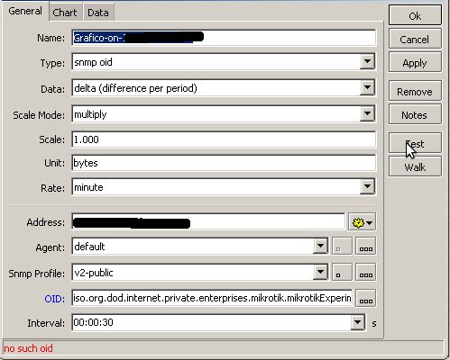

Using The Dude, I can do graphics with the accumulated bytes IN/bytes OUT of the queue simple?
I’m trying, but always shows an error no such oid.

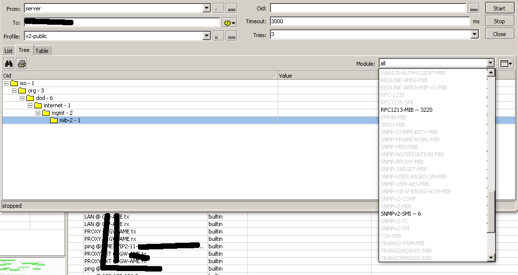

On snmpwalk appears MIKROTIK-MIB as disabled. Only SNMPv2-SMI and RFC1213 appear with enable…

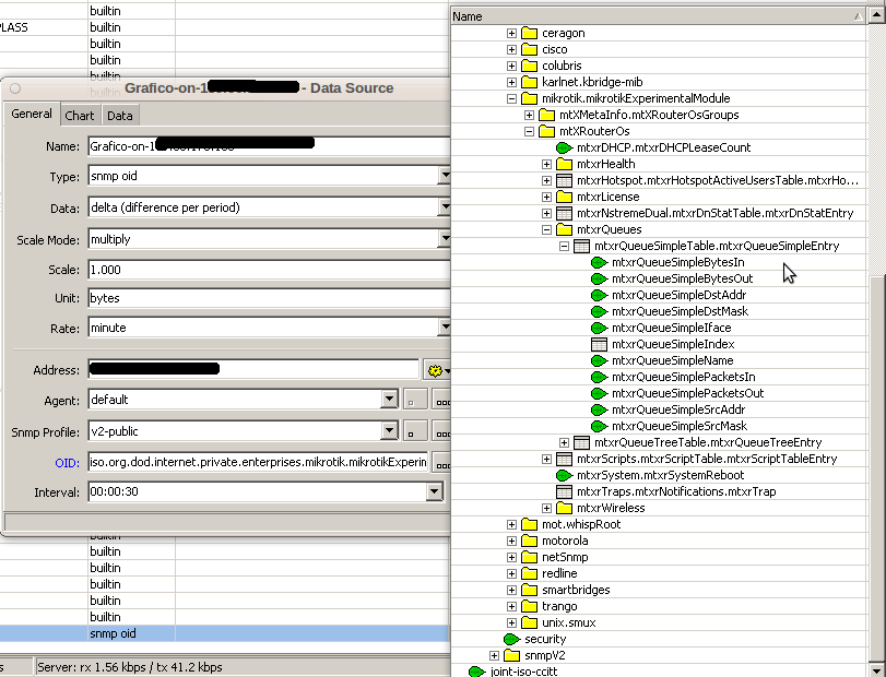

If you use the all (all modules of MIBs) that can be displayed the oids of Mikrotik Queue Simple, but after creating the Data Source when using the test button says no such oid.

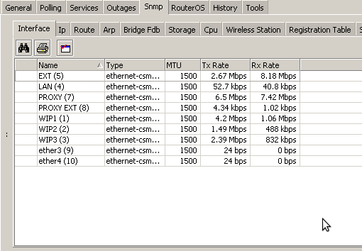

Below are some images that illustrate the problem. note that the SNMPv2 is up and running.
The last image

OID’s not disabled, they greyed-out because snmpwalk did’t find any snmp value from that class
Can you show you “all OIDs” snmpwalk, with data you needed screenshoot?
