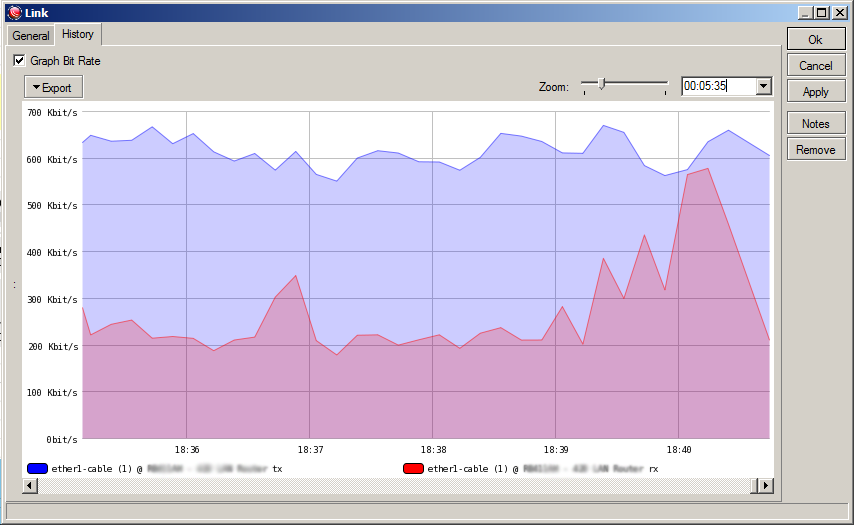

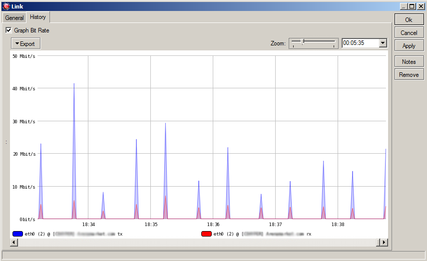

For some months now the traffic graphs are very weird.
I cannot explain it well so I am attaching 2 screenshots.
In case of a Linux/Windows device with standard Net-SNMP/Windows SNMP the graphs are with Peaks of X seconds/minutes (on a local device it’s every 10 seconds, on an internet device it’s every 5 minutes) even though the real traffic is nowhere near that.
In case of a Mikrotik RouterOS device, then the graphs are perfect.

600kbps is about 0bps, I would be curious what copy or batch job is moving a fairly large file every 30 seconds, 10Mbps. Is the dude collection actually causing that spike? You must be collecting the entire MIB if that is the case… that is what it looks like. Check your probes and make sure they are reasonable.
There are no spikes of traffic whatsoever.
This kind of graphs is recorded for ALL devices (except mikrotik devices).
I have graphs from cacti of the same devices and the traffic is smooth as the second graph I attached.
No I do not collect the entire MIB, and this traffic is not real. It does not exist. Only Dude registers it that way.

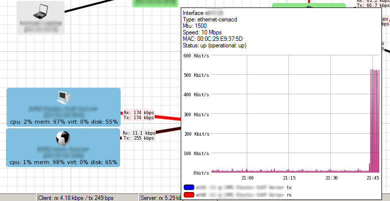

I forgot to mention that the link label with the real-time traffic indicator (I don’t know how it’s called) shows the real traffic.
So for example it might show 1mbit upload 200kbit download which is real traffic and properly measured, but on the graph it will put something like 10mbit upload and 2mbit download (roughly x10 times the real data).
Here is a screenshot of this.
174Kbps is the real traffic that actually runs through that ethernet but the graph shows roughly 520-530Kbps!
