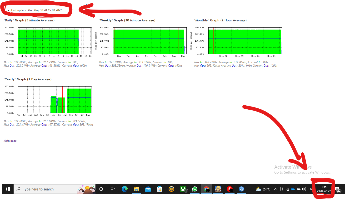

I have a problem with the graphing tool on MikroTik, when I check directly into MikroTik the graphing tool is still running and stored and displays current and previous graphs, but on the website display (192.x.x.x/graphs) the traffic that passes is stopped and does not continue today/week/month next.
here the website display

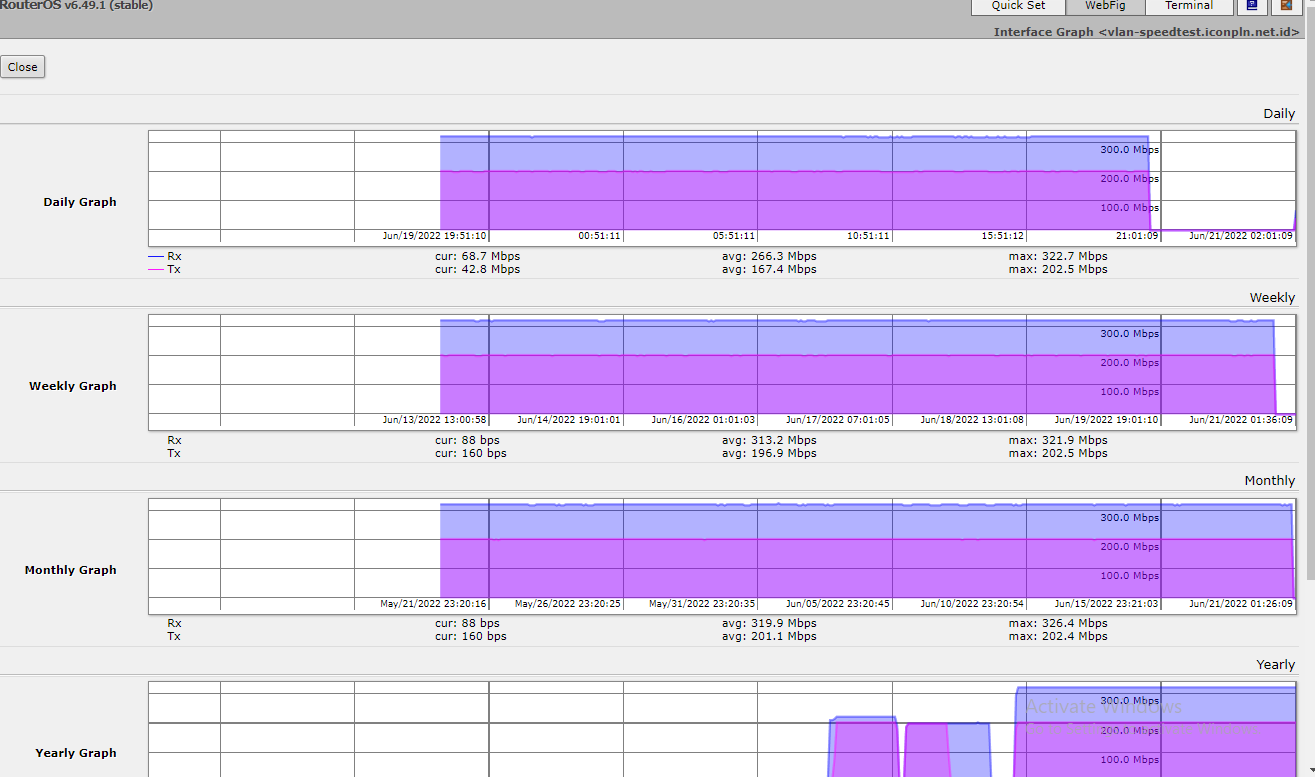

here the webfig (website) display

the data in the graph itself appears correct comparing 1:1 (webfig vs basic page), it may just be a visual time bug. I can assume the time is set correctly since webfig looks correct, but maybe try re-setting the time (timezone is correct, us an NTP server) and if that doesn’t help see if its still an issue after a reboot.
I’d say the graph display page is just working off the wrong ‘time’ (and date), but as said the graphs seem to match-up almost perfectly in display.
Thanks man
The problem is my mikrotik date stop at 30 May (i dont know why, maybe NTP server error or something)
So i just set second NTP server on my mikrotik then Mikrotik date back to actual date and graphing graph back to normal.
