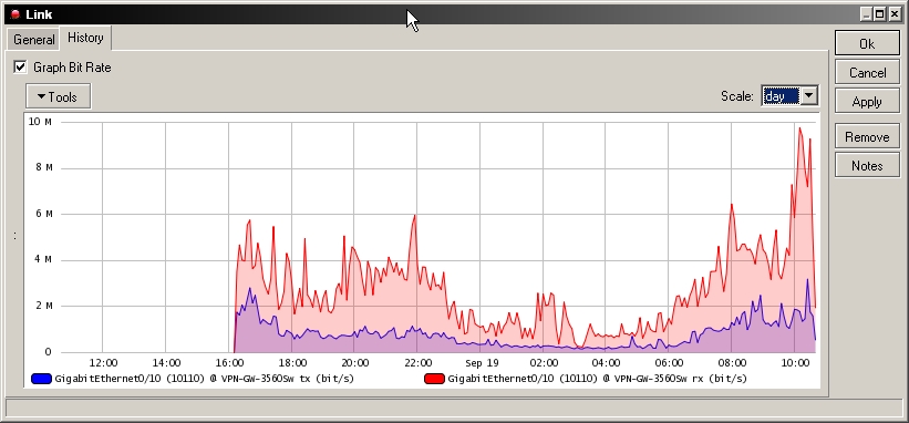

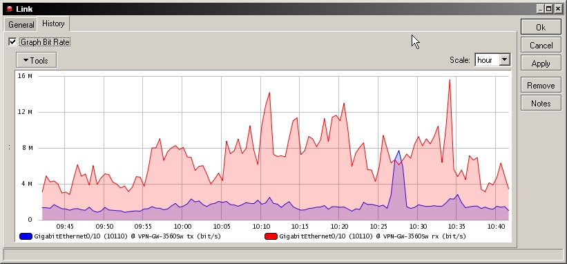

I just started using Dude, and like it. It still has several quirks, most of which can be worked around, but this one is an issue of accuracy. I am running 3.0RC3, and noticed that when I view the bandwidth utilization on several of the switches that I monitor, the graphing appears to be off when changing Scale. If you look at the graphs I attached below, the “hour” view you can see 3 spikes just in that hour that went between 12 and 16 MBPS. But when you look at the “day” view, the graph shows the highest peek to be less that 10 MBPS. Something doesn’t seem right there.

If you change the from hourly to daily you are going to change the look of the graph. What is the average throughput for 10:00?? About 10mbps right? This is what the daily scale is going to show you.

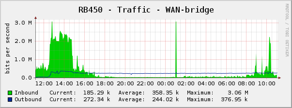

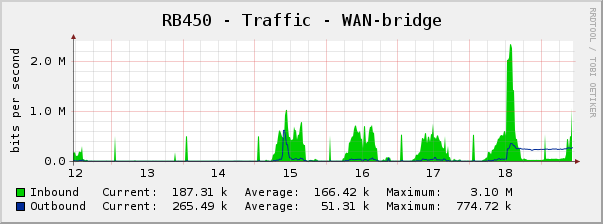

I have the same thing using cacti for graphing. See I have two spikes to 3M on the daily graph, but these are not going to show on the weekly graph.
Actually, besides changing the scale, you are changing the interval that the graph is showing, somehow the “granularity” of the graphic. If the daily graph will calculate a 5 minute average, the weekly will show let’s say a half an hour average.
That should enlight you.
The averaging of graphs over time is the only way to reduce the stored datasize… For example keep 60 samples for 1 hour and keep 48 samples for 1 day and ~720 samples for 1 month. If you tried to keep 60 samples for every hour for 1 month that would be ~43000 samples. That is a lot of samples… Averaging samples is the only way old data takes up less space but it becomes less meaningful since the max is averaged out.

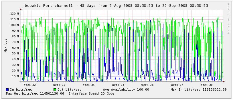

Here are example graphs from NMIS for 48 days with bits(average) and mbits(max) counters displayed…
