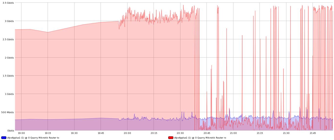

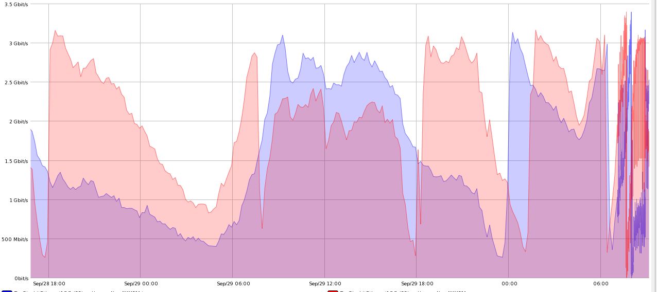

I am also seeing this issue or something like it. There are drops in my throughput when running around or over 3.5Gb. Max it graphs is below 3.5Gb. I will go over all my configurations to be sure it isn’t an issue on my end.
Router is a 1072 6.47.10(long term) and dude is running on x86(6.48.4).
-Mimbach
