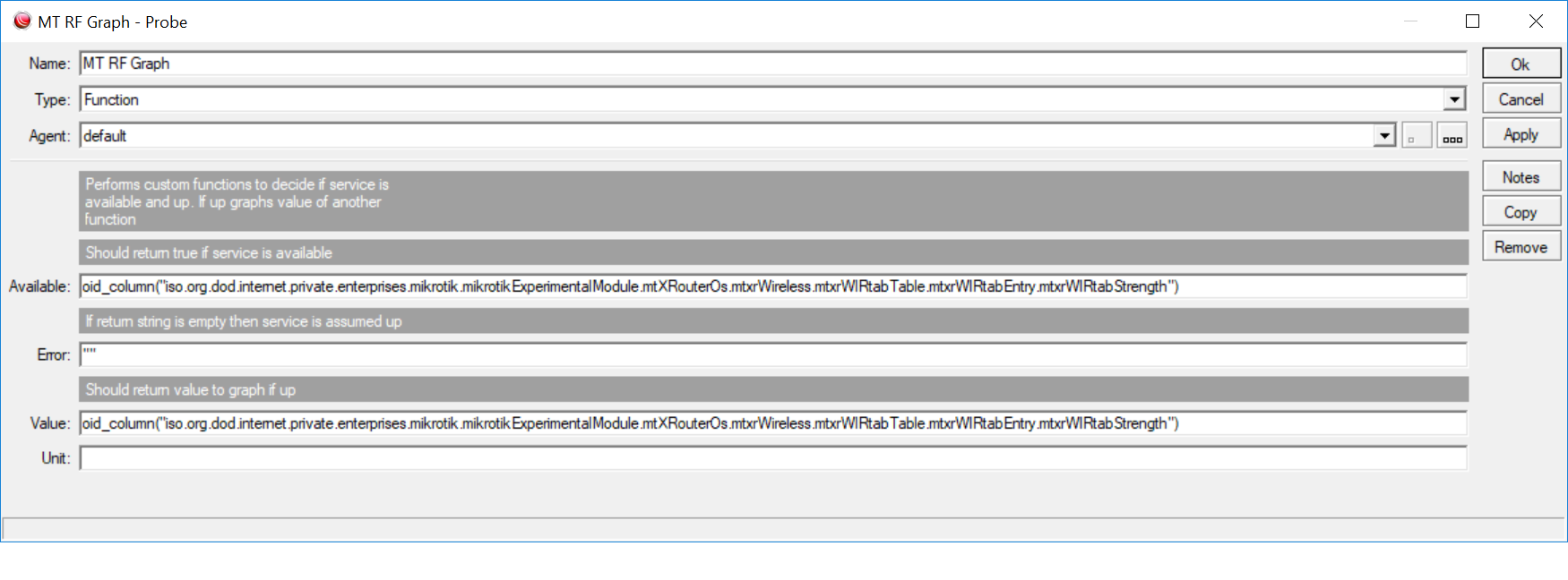

Lebowski! I wanna give you a hug! This works. I never knew about columns. I’ve been creating separate probes for links for years. You are a life saver! Wanna go bowling some time? lol For the future somebody that finds this, heres what it looks like after you put it into a dude probe.
