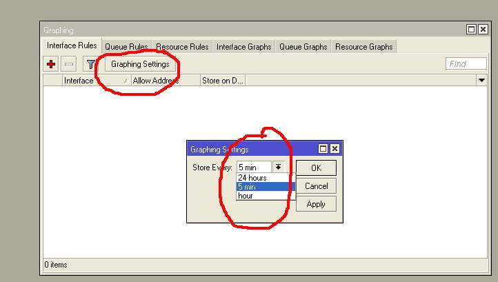

but you can change the timr of updating the graphs in “graphs”.
after any restarting.
you lost the previous graphs!
it is the rule of routers
good luck
I know only setting how often graphs are saved to disk (1 hour or 5 minutes). Where can I change time of updating graphs?
I’ve restarted routerOS v.4.xx many times and graphs were not lost (at most only last hour) - that’s because data were saved to disk every hour.

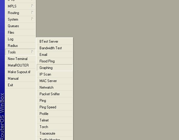

plz see the picture
Yes, this allows to set the frequency of storing data to disk. I’m using 5 minutes on some routers and 1 hour on some other - but all of them delete data after reboot in RouterOS v. 5.0 and 5.1. That’s the problem (and was not a problem in v. 4.x).
