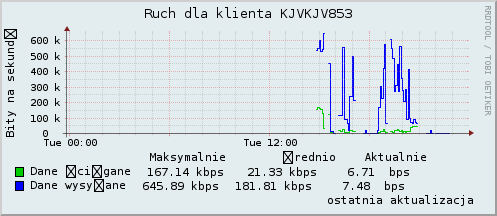

I’m using this script but I received some problems. Some users graphs are “fragmented” I suppose this due to the fact, that when user is disconnected, pppoe interface does not exist and paticular rrd database is not updated then. Did someone solve this problem somehow?
