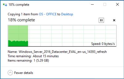

I have created a Gree Tunnel Over IPSec between Pfsense (responder) & Mikrotik RB4011iGS+ fw 6.43.8 (initiator) Success tunnel Established. Clients and Routers on both side can ping to each other.
But When Client from PFsense Side copying File Sharing from Client Mikrotik Side the copy speed is good in about 30 seconds, the speed decreases to 0MB/s. I wait for about 10-20s, the copy speed increases normally then decreases again after 30s. The increase and decrease of the copy speed takes place repeatedly until the copy is completed. Clients on both side can ping good to each other during Copying File
Any idea about how to solve this issue?
