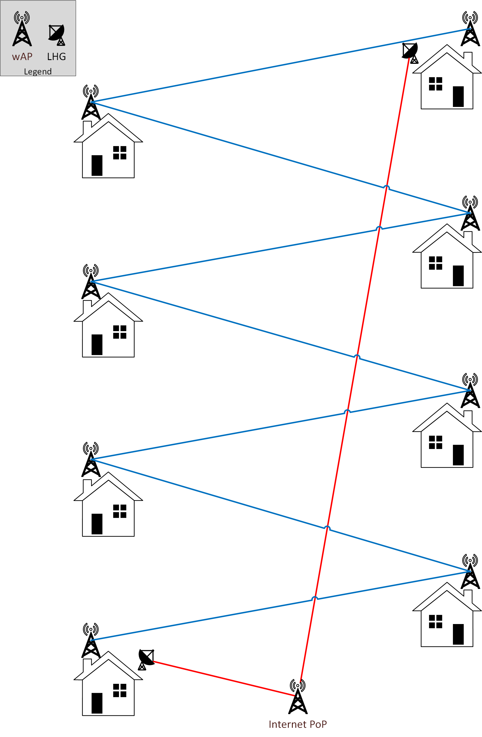

I am interested in this as well. I’m hoping to do something like a mesh network with the wAP 60G as seen in the attached diagram. Do you guys know if this is possible today with HWMP+ or other protocols?
@st91ang , interesting diagram. I have been thinking about doing something like this as well. How many wAP’s do you have on each home? what are your distances? how well does this work and what kind of speed per home are you seeing?
Riccochet did that in the late 1990’s and early 2000’s somehow successfully.
But at some point you hit a speed limit due to internal interference and multiple hop latency. Think of something like 1/8’th of a P2P link.
I have not actually implemented this but was theorizing how I could serve a couple of neighborhoods I’ve been looking at. I was thinking 100Mbps packages for the customers due to all of the repeating of signal required.
