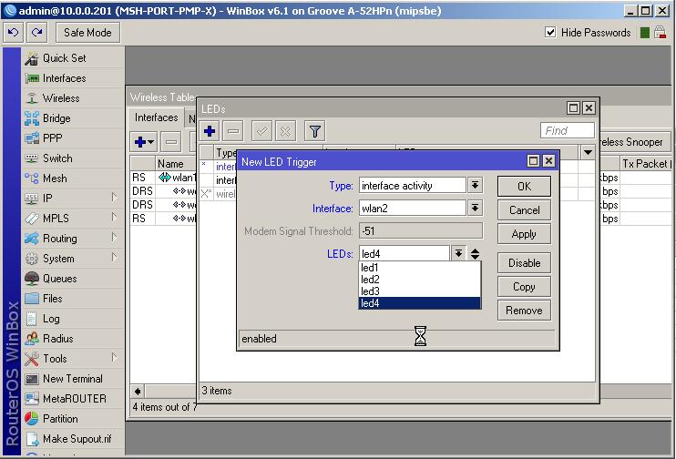

I’m current working on Groove A-52HPn hardware and noticed that LED5 is not configurable.
RouterOS v6.1

When I ported the configs to the new Groove A-52HPn hardware, the network worked without issue, but I noticed that my LED5 was not showing any wlan2 interface activity. (set up in 5GHz mode)
I went to manually configure it (see attached image), and notice LED5 was not available in the dropdown box, only LED1-LED4

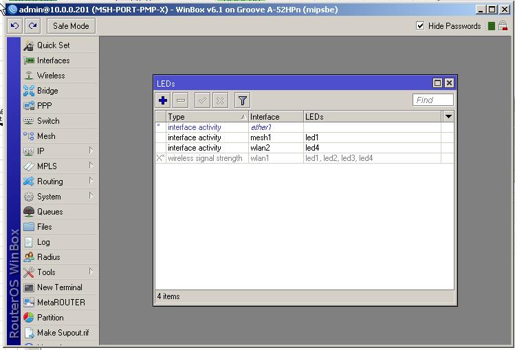

So I set LED4 up to show wlan2 activity, and rebooted the router.
On reboot – BOTH LED4 and LED5 lit up? – showing wlan2 activity…even though ONLY LED4 was configured (see attached image)
The Groove A-52HPn clearly says the LEDs are all configurable – but clearly LED5 is not.
So I am wondering if there is issue in RouterOS or in the hardware?
I am also wondering if LED4 and LED5 both light up when the hardware is used as a client and sees signal strength?
I’m not looking for help, as I can work around this OK, but just wanted to highlight it.

In all RouterOS versions Groove A-52HPn has 4 configurable LEDs, command “/led led4=yes” turns on LED4 and LED5.
LED4 and LED5 control was united in RouterOS due to hardware restrictions and this is specific to only Groove A-52HPn.
