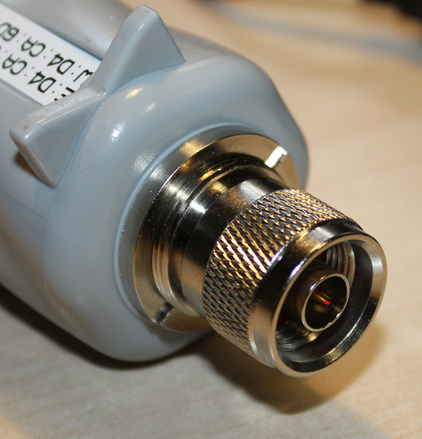

Have you look to the pin or that is not pressed in? see the red dot
