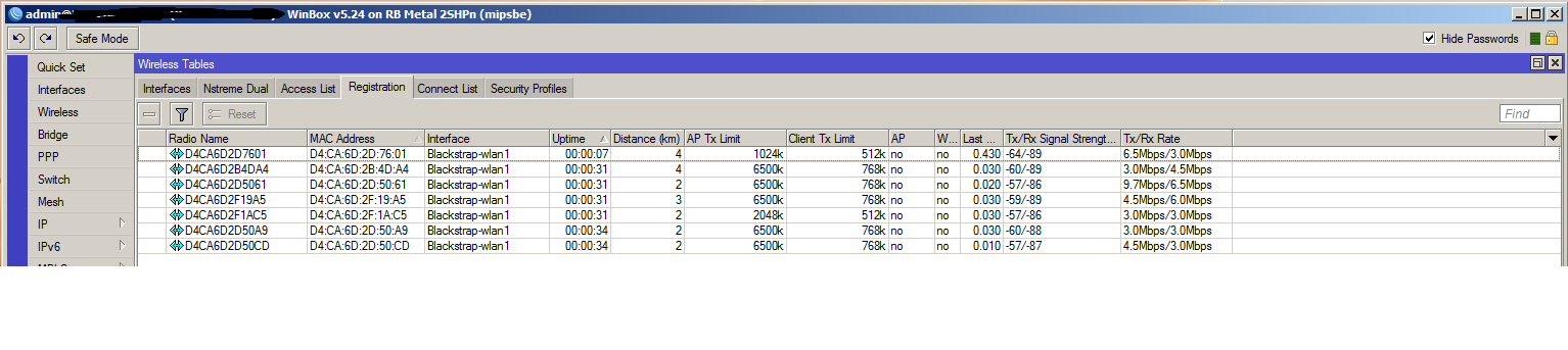

I have a few Groove A2Hn and Metal 2SHPn AP’s installed with about 5-15 customers on each. I have had the Rx level suddenly drop for all customers. I now have six AP’s that I have had to replace. Some sites have been replaced multiple times. I do not believe it to be a CPE side problem as it happens with all connected subscribers and at the exact same time. When I replace the AP all the levels return to normal.
I have tried moving from Groove A2Hn to the Metal unit with no luck as the Metal will fail (one site as quickly as 12 hours later). I have four other Groove A2Hn’s installed for over 6 months which have had no problems at all. Firmeware also makes no difference. I am contemplating building AP’s with an RB411 and a 52Hn card. No response yet from Mikrotik support on my open ticket.
The screen shot shows what I am experiencing. The Rx level has dropped on all the modems, where as the Tx is fine. These used to only vary by 2-3dB as would be expected.
