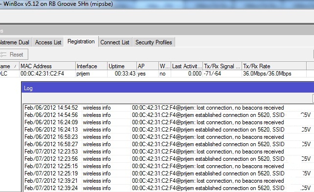

I have a problem. Since I have upgraded a couple of groove from 5.9 to 5.12 i get a lot of “lost connection, medium access timeout”. They were working ok with 5.9. I will try to downgrade an see if the problem disappear. Anyone had similar problem?

I can confirm that after downgrade to 5.9, groove is working OK. Can mtk guys join the discussion regard this problem?
I discovered it after moving to 5.11, it occurs every day, but only on one of the two grooves that I have. It’s the groove with the weaker signal strength (-72 dBm) that gets this ‘medium access timeout’, the other one (-55 dBm) works flawless.

On booth of them everything is OK with 5.9 downgrade. By looking at 5.10 changelog, I have found out that they have changed something about snmp. I am using snmp for dude signal reporting. Maybe I am wrong, but you can never tell:
“snmp - provide extended interface statistics when availabe”
I can’t experiment any more with those grooves because they are used by important clients!

Thanks for the link. I disabled snmp and I will give you an update shortly if this makes a difference.

I am using NV2. Unfortunately I can’t experiment any more. 5.9 is working, so I’ll be waiting for solution…
I am using 802.11 and SNMP is off. I can experiment :slight_smile:
thanks for the advice. after disabling snmp the issue is gone. it is nv2
