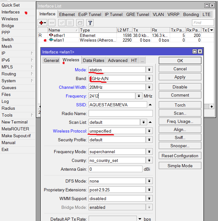

set 0 band=2ghz-b/g/n mode=station-pseudobridge ssid=AQUESTAESMEVA
[admin@sdflkjei93jdsk] >

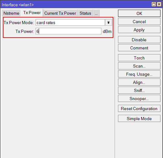

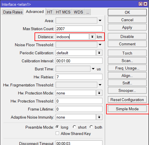

I had already tried setting indoors and lowering the power to 15 as I had read in the forums too much power could be an issue. I have now lowered to 6 and tried again. Still no connection.
Here is the command you requested (I tried with 0 but gave error, so I guessed the 0 was a mistake):

please upgrade to the RouterOS v6.0rc10 which will be in the download page today and after that please reset the wireless configuration by using this command:
/interface wireless reset-configuration wlan1
And after that try to configure the settings you need.
Also please use the regular export command so we could see the changes what are different form the default.

Upgraded to rc10, reseted the wireless configuration with the command suggested by uidis, and tested first, only changing the band from default B to B/G/N (AP does not have B) and then changing the rest as suggested (lowering the power, setting indoor as distance, etc…). The AP is unprotected. Same results. Im including the export of each case and at the end the logs that Im getting in case they are relevant.
After reset:
[admin@sdflkjei93jdsk] > /interface wireless export
# jan/02/1970 00:04:38 by RouterOS 6.0rc10
# software id = DWT8-W9NU
/interface wireless
set 0 band=2ghz-b/g/n disabled=no l2mtu=2290 mode=station-pseudobridge \
    ssid=AQUESTAESMEVA
After changing the power and other stuff:
# jan/02/1970 00:12:34 by RouterOS 6.0rc10
/interface wireless
set 0 antenna-gain=14 band=2ghz-b/g/n country=spain disabled=no \
    distance=indoors l2mtu=2290 mode=station-pseudobridge ssid=\
    AQUESTAESMEVA tx-power=6 tx-power-mode=card-rates

Try setting the tx-power-mode=default if it connects or not.
The first test was done with tx-power-mode=default, you can see it in the logs. The second I changed it to lower the output as suggested by ohara.
Look guys this issue is not related to tx-power at all -leave it to default
If I m not wrong you use mode=station-pseudobridge
Can u set it to station or station bridge? and give it a try - scan select ur network and press connect
Im using mode=station-pseudobridge because its what automatically is set when you use the new quick setup screen of version 6.0. Previously I was using mode=station. Regardless I tested again with all three methods again today after a full reset. Same results.
Station-pseudobridge:
[admin@MikroTik] > /interface wireless export
# jan/02/1970 00:07:23 by RouterOS 6.0rc10
/interface wireless
set 0 disabled=no l2mtu=2290 mode=station-pseudobridge ssid=AQUESTAESMEVA
[admin@MikroTik] >
Station:
# jan/02/1970 00:10:44 by RouterOS 6.0rc10
/interface wireless
set 0 disabled=no l2mtu=2290 ssid=AQUESTAESMEVA
[admin@MikroTik] >
Station-bridge:
My AP would not accept this mode and the logs would show that the connection was not possible because the AP was not compatible with this method (or something like that).
# jan/02/1970 00:11:41 by RouterOS 6.0rc10
/interface wireless
set 0 disabled=no l2mtu=2290 mode=station-bridge ssid=AQUESTAESMEVA
[admin@MikroTik] >

only set band as b/g/n
Also try Wireless Protocol=802.11 or any
