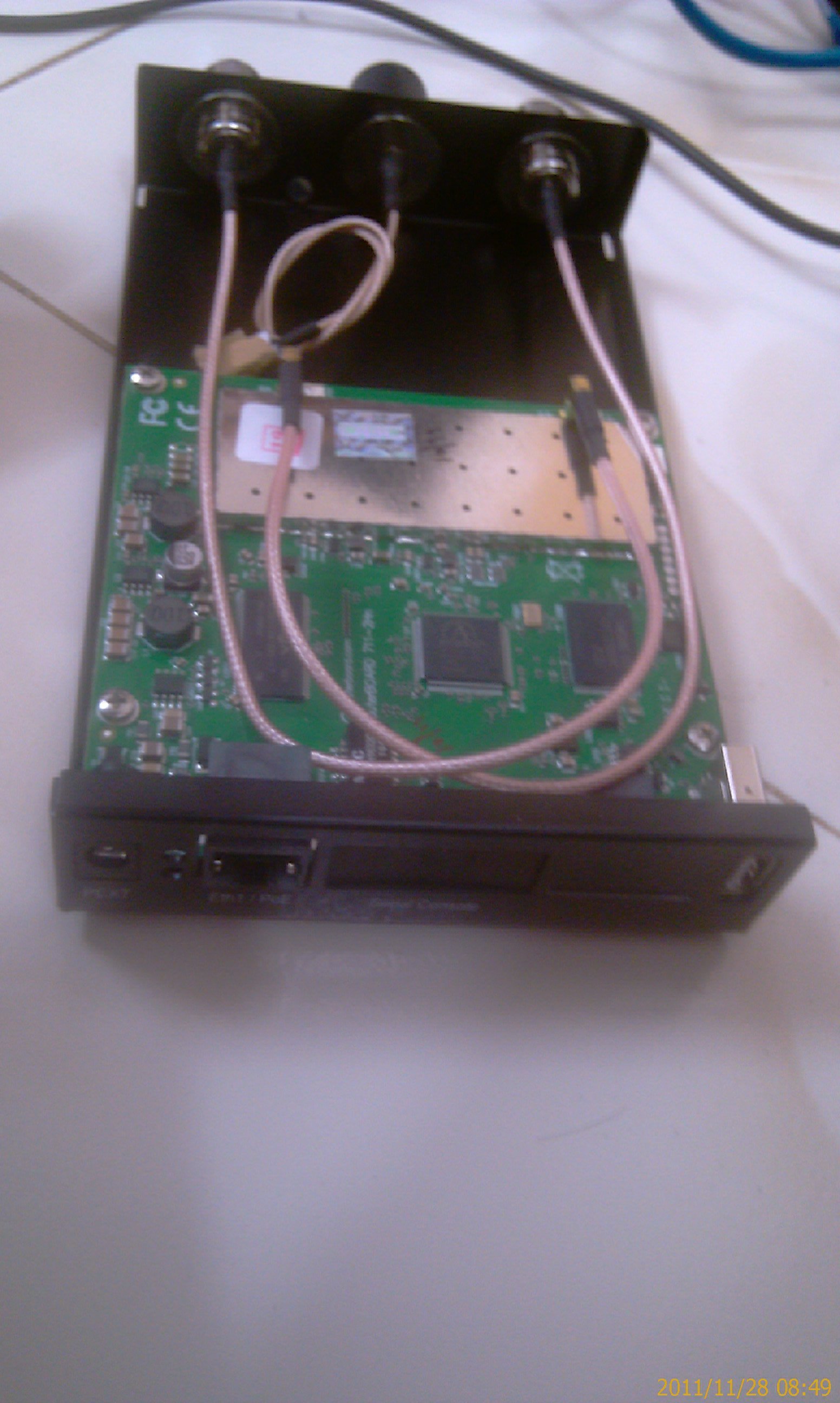

I have installed a RB711UA-2HnD board in a CA/411U casing. (Picture attached)
Now when i insert the Power Supply (i.e. 24v DC) in the Wall plug and the other end into the routerboard I can feel current passing through the entire casing even before switching it on. The wall plug has been tested for earthing and has no issues.
I just fail to understand why this happens.
help…

make sure nothing is touching the board, i see your antenna pigtails are touching, maybe they are shorting something.
even if i keep the board outside the enclosure with the pigtails connected the same things happen.

also the points of contact are
  1. the 4 mounting screws in the enclosure.
  2. the pigtails with N connector (bulkhead) coming out of the enclosure from behind.
as i said when the board is unmounted and kept aside with the pigtails still connected the same thing happens. i can feel the current in the enclosure.
anything connected to the board in any metal form is making this happen. how can i overcome this issue?

no pole… it is an indoor unit. you can refer to the photo at the start of this thread.
