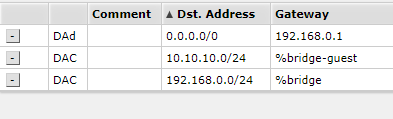

So - the only reason can be that the routing from my new network to other networks doesn’t work. But if I check routes on IP I can see my routes, also to 0.0.0.0 which takes the IP of the RB4011 main bridge.
What do I miss? Is there any setting which I need to make that the guest wifi knows how to route?
