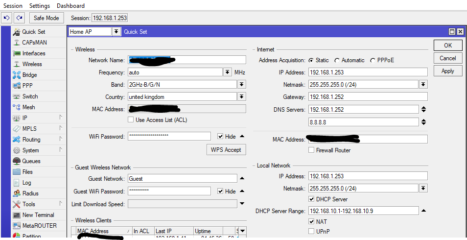

Quick set screenshot attached
You have incorrectly set IP addresses.
Internet and Local network can not be in the same range.
oops, changed that now. Still not working. I’m going to reset to defaults and retry. Thanks for the help so far.
