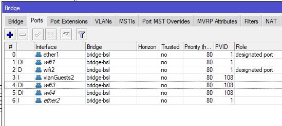

You did not add wifi interfaces to bridge/port ?
They should be added as untagged, not the VLAN itf itself.

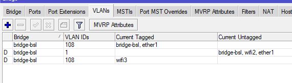

Once i connect to wifi3 interface its getting added dynamicly to that port, see screenshot, is that what you mean?
2 tabs to the left.
Bridge / ports

Ah sorry, the wored untagged confused me since i could only find it in there but i know what you meant.
But i owe you a big thank you, the settings were as below and after i removed the vlan config from the wifi3 and wifi4 it finaly works, took me a week but learned a lot.
