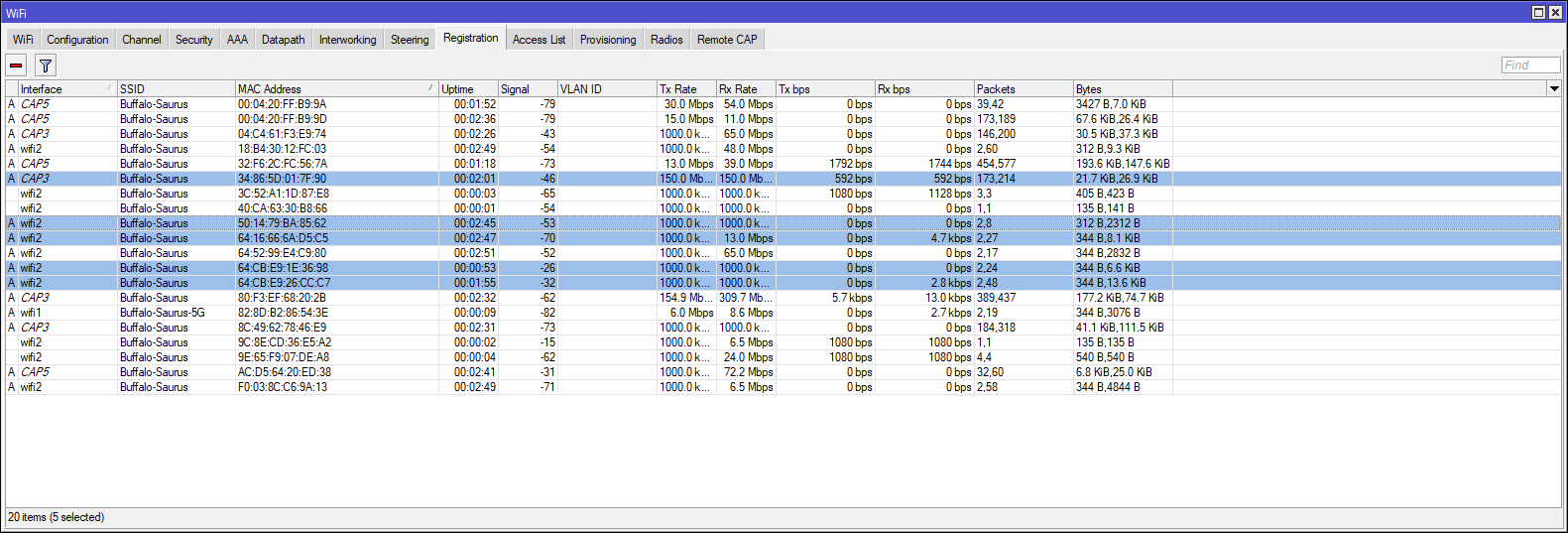

I’m having an issue when attempting to set up a guest wifi using capsman using my hAP ax3 as the router/manager.
as soon as i build the slave configuration, and “provision” to the radios, i start losing devices off my main 2.4ghz wifi.
Devices highlighted in the screenshot (registration.png attached) show up in the registration table, but do not receive an IP, and are not accessible on the 2.4 ghz wifi.
These same devices work perfectly as soon as i restore to a previous config.
im hoping someone else has seen this issue, and can assist or point me to a resource that can help solve the problem.

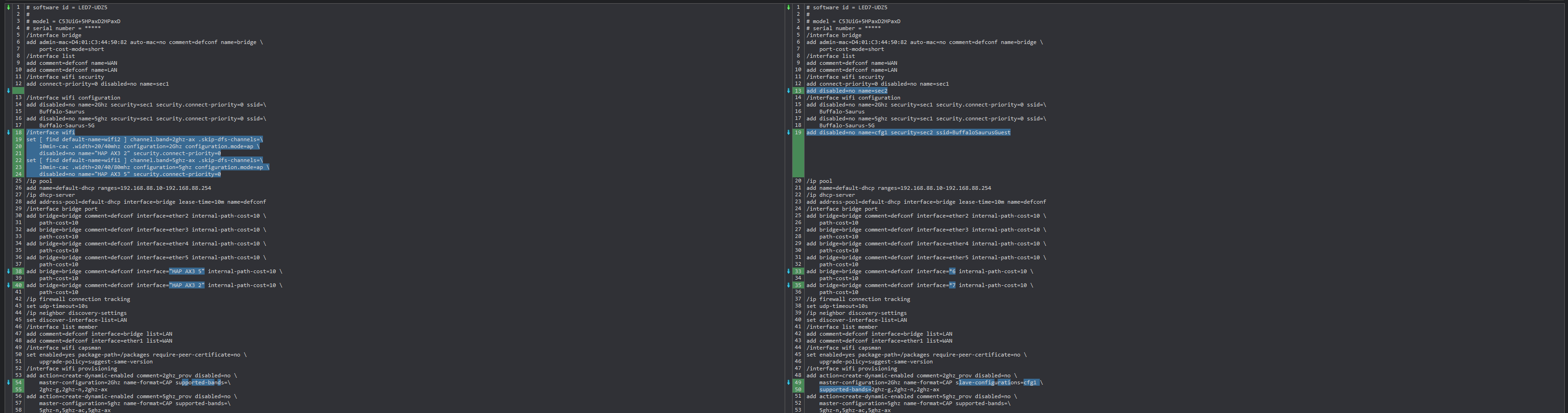

#Config with guest wifi:
# 2024-06-18 16:15:54 by RouterOS 7.15.1
# software id = LED7-UDZ5
# model = C53UiG+5HPaxD2HPaxD
# serial number = *****

#working config - no guest wifi:
# 2024-06-18 16:34:21 by RouterOS 7.15.1

Apparently you cannot provision local interfaces with CAPsMAN (see http://forum.mikrotik.com/t/hap-ax3-wifiwave2-capsman/163543/35). Have you tried to directly apply the configuration to the master and slave interfaces?
can you perform a diff of former config and current one? e.g. https://www.text-compare.com
screenshot attached with the differences.
thanks im going to give this a whirl and see if i can get it to work
