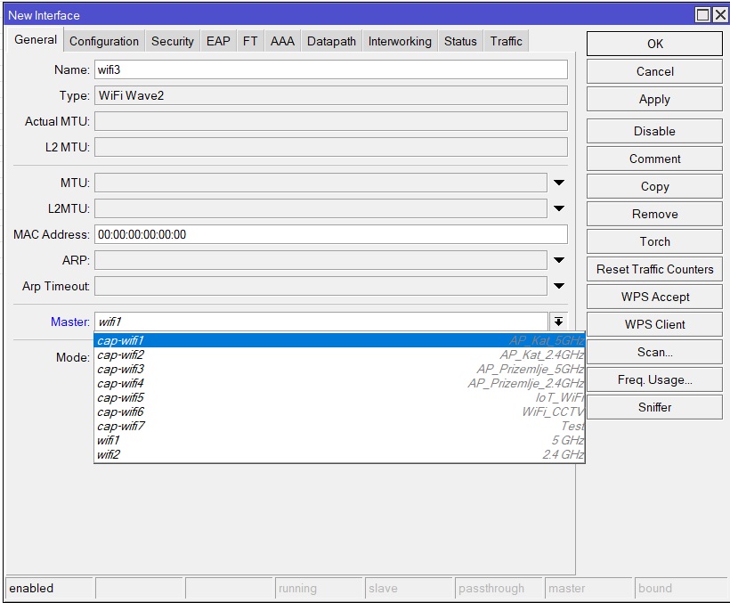

You create new virtual interface and you have an option called Master where you can select what interface will be master interface for newly created virtual interface, for example you select cap-wifi3.

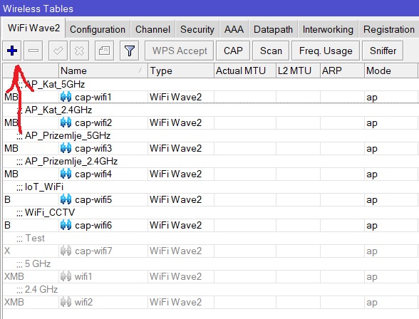

So under Wireless menu you should have something like this:
And when you press “+” you should get this:
Here you should be able to choose what interface is master.
Interfaces 5 and 6 are virtual in my case and cap-wifi4 is selected as master interface in my case
