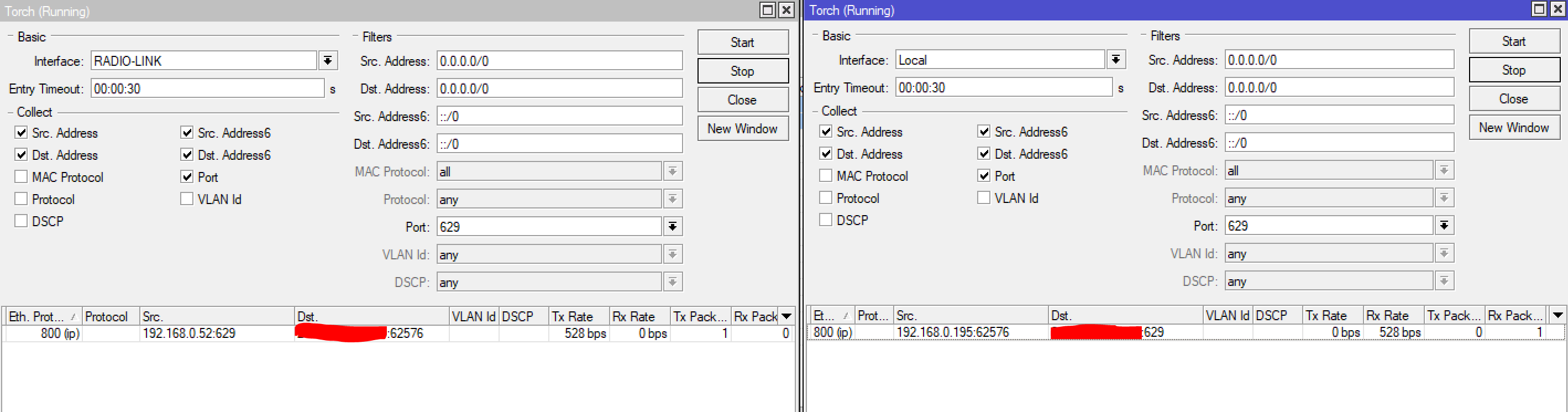

when i check with torch, only 1 package showing, then connection refused. Red area is RADIO-LINK’s external IP (eg: 1.1.1.10)
