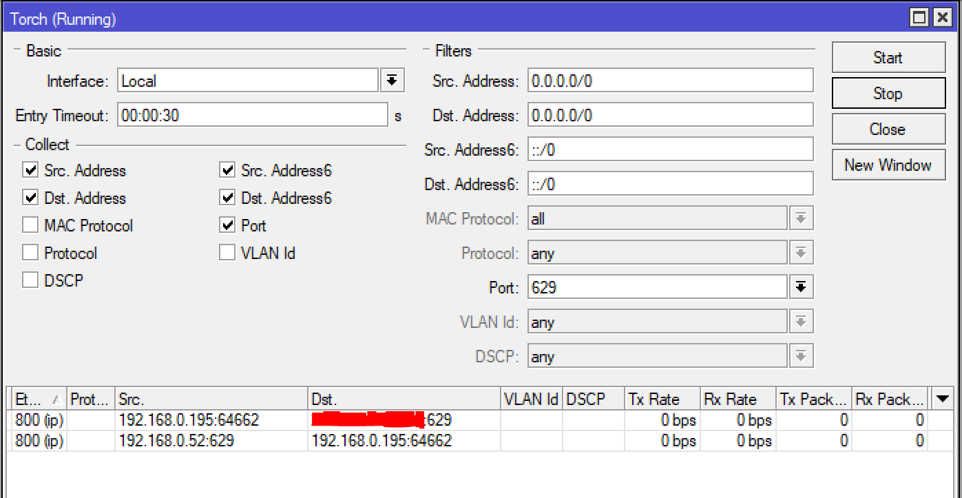

In torch tool only “Local” interface was catches packages. (I guess this is normal)

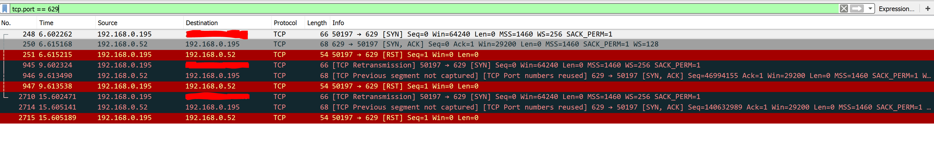

Instead of torch, use packet sniffing to file and Wireshark to see what the response from the server was. At this stage we need to know whether the Mikrotik rejects the TCP session establishment or the server does. @Anumrak’s question expresses a suspicion that the server may refuse requests coming from Mikrotik’s own address (which is the case when the client connects to 1.1.1.10 and Mikrotik does a dst-nat and src-nat while forwarding the request) while it accepts requests coming from another address in the same subnet (which is the case when the client connects to 192.168.0.52 which means that routing and all firewall rules on Mikrotik are bypassed).
Wireshark result with filter (port 629) from client. (192.168.0.195)
You have TCP Reset segments. They transmitted because of wrong or not existing connection. Try to make hairpining to something else in your LAN.
What I can see in the capture is that the initial SYN packet from the client goes to the public address, but the response SYN,ACK from the server comes from the real address of the server, which makes the client send a RST as the SYN,ACK comes from an unexpected source. So the src-nat action (not necessarily rule!) in the server->client direction fails.
@emrah, I assume the client and the server are connected directly to RouterBoard’s physical ports, or, if some other switching gear is between them and the RouterBoard, that it is possible for you to re-arrange cabling in such a way that the client is connected through one physical port of the RouterBoard and the server through another one. Once you are sure that the physical path between the cleint and server goes through the RouterBoard, sniff at both ports simultaneously. And set a display filter “tcp.port == 629 or icmp” when taking the screenshot of the result in Wireshark.
Either one of your NAT rules does not work as expected (maybe because connection tracking does not work), or the RouterBoard sends an icmp redirect to the server when it finds out that it should forward a packet to the same subnet from which it has arrived, so the server re-sends the packet directly to the client.
