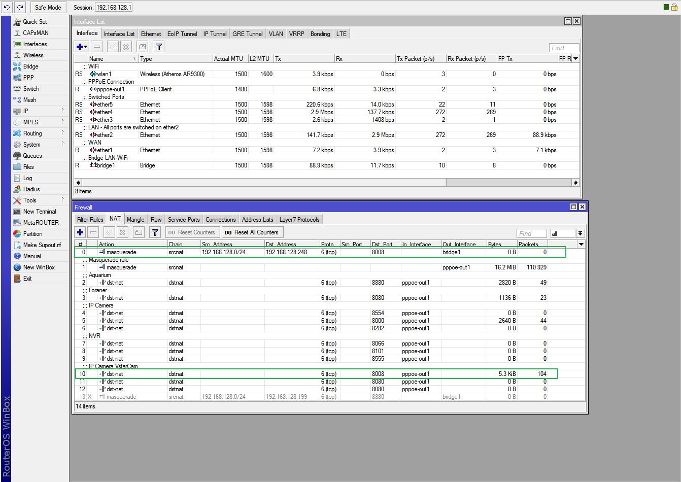

add chain=srcnat src-address=192.168.128.0/24 dst-address=192.168.128.199 protocol=tcp dst-port=8880 out-interface=LAN action=masquerade
Well I’m definitely missing something major here. :slight_smile: :blush:
I tried few times to use the rule but “no juice”.
I tried to create two different rules for two different devices, but no success.
Any ideas?

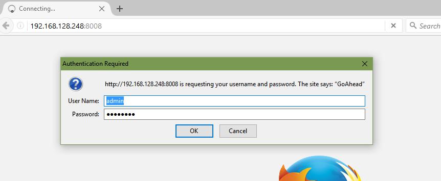

My master interface is bridge1 (where the rule is targeting). Is this correct?
The indicated rule is targeting correctly an active device and an active port:
What am I doing wrong? :confused:
The problem is your dst-nat rule. You have in-interface=pppoe-out1, which works fine for traffic coming from outside your network. However, your local traffic never hits that interface. You will need something like this:
/ip firewall nat add chain=dstnat dst-address-type=local dst-address=!192.168.0.0/16 dst-port=8008 protocol=tcp action=dst-nat to-address=192.168.128.248 to-port=8008
Now your hairpin should work.
