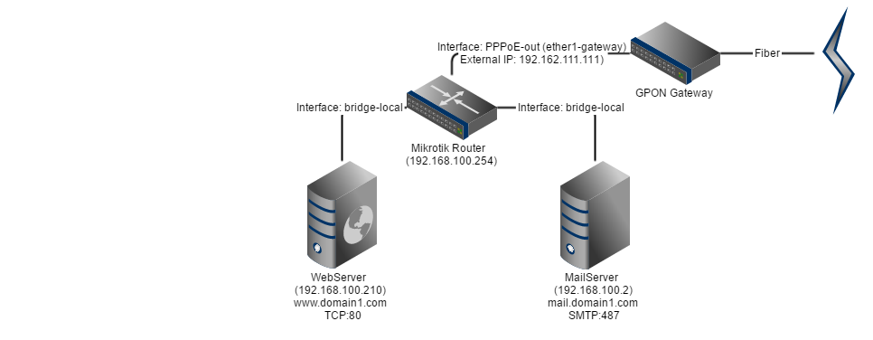

Please help me to find reason why my router do not goes to external domains locally.
chain=srcnat action=masquerade out-interface=pppoe-out log=no log-prefix=""
chain=dstnat action=dst-nat to-addresses=192.168.100.210 protocol=tcp dst-address=192.168.111.111 dst-port=80 log=no log-prefix=""
chain=dstnat action=dst-nat to-addresses=192.168.100.2   protocol=tcp dst-address=192.168.111.111 dst-port=487 log=no log-prefix=""
chain=srcnat action=masquerade src-address=192.168.100.0/24 dst-address=192.168.20.100.0/24 out-interface=pppoe-out1 log=no log-prefix=""
My domain www.domain1.com is working fine but from outside of my network.
The problem is why domain www.domain1.com is not working from my local network.

But if your WAN address is really 192.168.111.111, i.e. non-public one, your problem is elsewhere. Either haipin NAT must be done by the router with public address used by your domain, or you must create another set of dstnat rules on your router with dst-address=, to catch packets early and don’t let them go out.
Sorry for wrong example address 192.168.111.111- this should be any external IP 192.162.150.20
Last rule should be ?
chain=dstnat action=dst-nat to-addresses=192.168.100.210 protocol=tcp dst-address=192.162.150.20 dst-port=80 log=no log-prefix=""
chain=dstnat action=dst-nat to-addresses=192.168.100.2   protocol=tcp dst-address=192.162.150.20 dst-port=487 log=no log-prefix=""
chain=srcnat action=masquerade src-address=192.168.100.0/24 out-interface=bridge-local log=no log-prefix=""
Can you please put correct rule ?
What you have should work. If it doesn’t, make sure you allow packets from bridge-local to bridge-local in forward chain.
