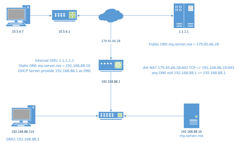

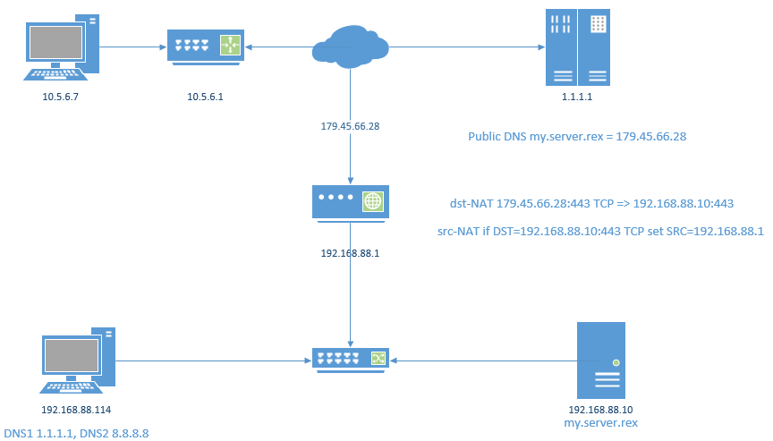

# external NAT
add action=dst-nat chain=dstnat dst-address=179.45.66.28 dst-port=443 protocol=tcp to-addresses=192.168.88.10
# internal misconfiguration fix
add action=src-nat chain=srcnat src-address=!192.168.88.1 dst-address=192.168.88.10 dst-port=443 protocol=tcp to-addresses=192.168.88.1

This is just a very narrow example, and it refers only to the graph made...

Not to correct or criticize someone, but there is no graph in the entire post to clarify the OP's ideas...

Your diagram in Hairpin NAT instruction inconsistency? - #26 by rextended captures my setup.
