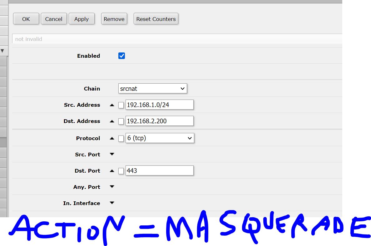

I have a mikrotik setup in the following way
Wan: 10.10.10.11
Lan 1: 192.168.1.X
Lan 2: 192.168.2.X
On Lan 2 I have a DVR device on port 443 on ip 192.168.2.200
I reach it with a public address from outside with the following dns
mynames.dns:443
But not from the inside, I have configured a nat hairpin but it doesn’t work
192.168.1.200:443 internal work
Where am I wrong?
Could somebody help me out?
My configuration in attachments
