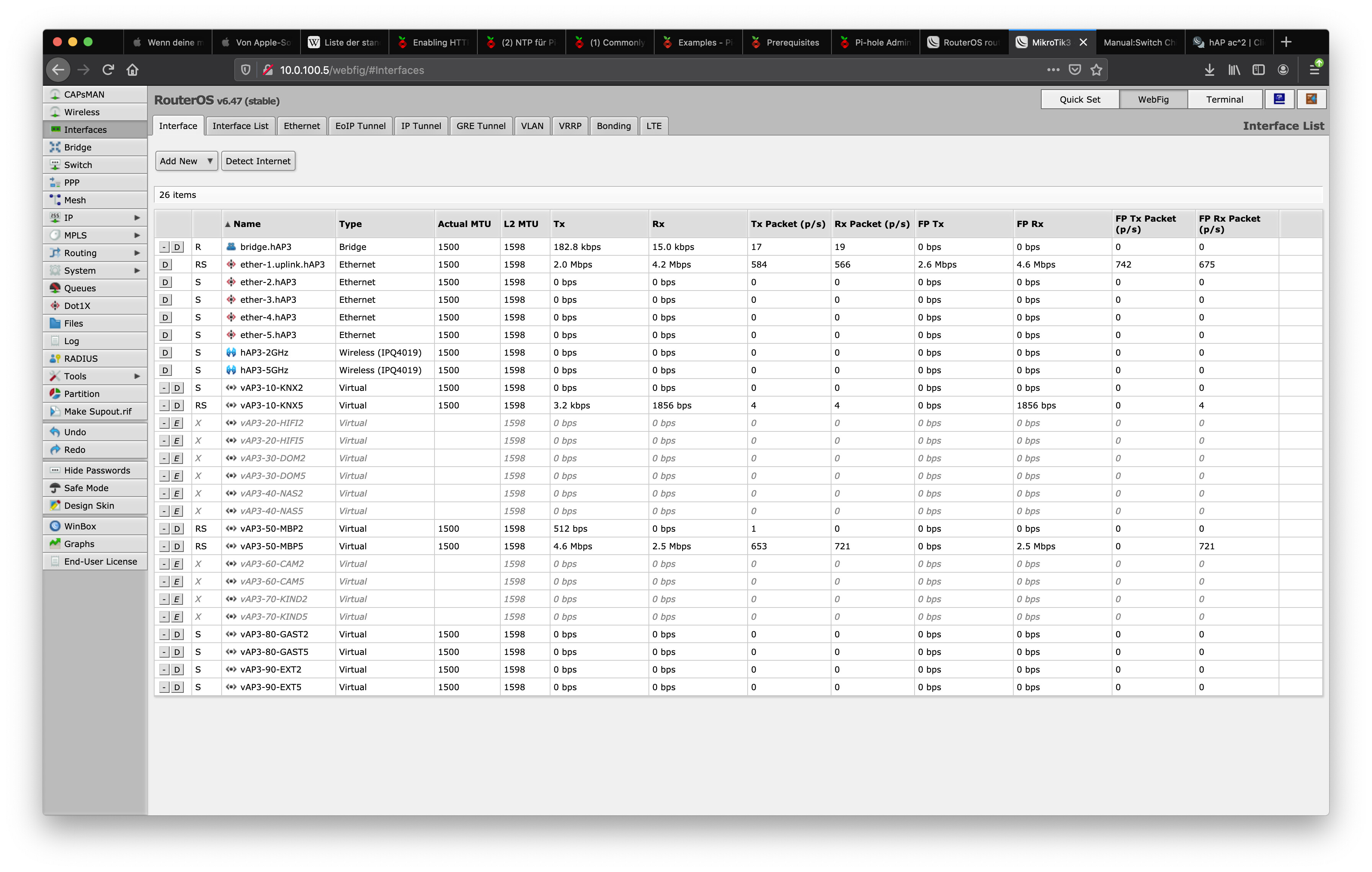

booh … thats rich … if you have winbox, can you post a screenshot from your “interfaces list”
if made a sketch before you started to configure all these … ? … can you share … I’m a picture man.
I can’t figure what’s the purpose of all this ! : |
There is only …
1x bridge
5x ether
2x wlan (chip of 2- and 5GHz) and on that
9x vAP, means 9x VLAN via radio on wlan1 2GHz and
9x vAP, menas 9x VLAN via radio on wlan2 5GHz
Here some pic of interfaceces …
revisited …

Sorry, what relevant information did I miss to post, please ? Do you need the whole export ?
Do you need it as plain text or in a file attached ?

Here the export (I had to delete the wireless security profiles) as the command “export hide-sensitive” doesn’t.
[91@MikroTik3] > export hide-sensitive
# jul/11/2020 15:57:25 by RouterOS 6.47
# software id = DE73-UYRN
# model = RBD52G-5HacD2HnD
add admin-mac=48:8F:5A:24:7A:D6 auto-mac=no name=bridge.hAP3 protocol-mode=none vlan-filtering=yes
set [ find default-name=ether1 ] name=ether-1.uplink.hAP3
set [ find default-name=ether2 ] name=ether-2.hAP3
set [ find default-name=ether3 ] name=ether-3.hAP3
set [ find default-name=ether4 ] name=ether-4.hAP3
set [ find default-name=ether5 ] name=ether-5.hAP3
/interface wireless
set [ find default-name=wlan1 ] band=2ghz-g/n country=austria disabled=no frequency=auto installation=indoor l2mtu=1598 mode=ap-bridge name=hAP3-2GHz ssid=MikroTik3-2GHz wps-mode=disabled
set [ find default-name=wlan2 ] band=5ghz-a/n/ac channel-width=20/40/80mhz-Ceee country=austria disabled=no frequency=auto installation=indoor l2mtu=1598 mode=ap-bridge name=hAP3-5GHz ssid=MikroTik3-5GHz wps-mode=disabled
add disabled=no l2mtu=1598 mac-address=4A:8F:5A:24:7A:12 master-interface=hAP3-2GHz name=vAP3-10-KNX2 ssid=WBC-KNX2 vlan-id=10 vlan-mode=use-tag wps-mode=disabled
add disabled=no l2mtu=1598 mac-address=4A:8F:5A:24:7A:15 master-interface=hAP3-5GHz name=vAP3-10-KNX5 ssid=WBC-KNX5 vlan-id=10 vlan-mode=use-tag wps-mode=disabled
add l2mtu=1598 mac-address=4A:8F:5A:24:7A:22 master-interface=hAP3-2GHz name=vAP3-20-HIFI2 ssid=WBC-HiFi2 vlan-id=20 vlan-mode=use-tag wps-mode=disabled
add l2mtu=1598 mac-address=4A:8F:5A:24:7A:25 master-interface=hAP3-5GHz name=vAP3-20-HIFI5 ssid=WBC-HiFi5 vlan-id=20 vlan-mode=use-tag wps-mode=disabled
add l2mtu=1598 mac-address=4A:8F:5A:24:7A:32 master-interface=hAP3-2GHz name=vAP3-30-DOM2 ssid=WBC-DOM2 vlan-id=30 vlan-mode=use-tag wps-mode=disabled
add l2mtu=1598 mac-address=4A:8F:5A:24:7A:35 master-interface=hAP3-5GHz name=vAP3-30-DOM5 ssid=WBC-DOM5 vlan-id=30 vlan-mode=use-tag wps-mode=disabled
add l2mtu=1598 mac-address=4A:8F:5A:24:7A:42 master-interface=hAP3-2GHz name=vAP3-40-NAS2 ssid=WBC-NAS2 vlan-id=40 vlan-mode=use-tag wps-mode=disabled
add l2mtu=1598 mac-address=4A:8F:5A:24:7A:45 master-interface=hAP3-5GHz name=vAP3-40-NAS5 ssid=WBC-NAS5 vlan-id=40 vlan-mode=use-tag wps-mode=disabled
add l2mtu=1598 mac-address=4A:8F:5A:24:7A:62 master-interface=hAP3-2GHz name=vAP3-60-CAM2 ssid=WBC-CAM2 vlan-id=60 vlan-mode=use-tag wps-mode=disabled
add l2mtu=1598 mac-address=4A:8F:5A:24:7A:65 master-interface=hAP3-5GHz name=vAP3-60-CAM5 ssid=WBC-CAM5 vlan-id=60 vlan-mode=use-tag wps-mode=disabled
add l2mtu=1598 mac-address=4A:8F:5A:24:7A:72 master-interface=hAP3-2GHz name=vAP3-70-KIND2 ssid=WBC-KIND2 vlan-id=70 vlan-mode=use-tag wps-mode=disabled
add l2mtu=1598 mac-address=4A:8F:5A:24:7A:75 master-interface=hAP3-5GHz name=vAP3-70-KIND5 ssid=WBC-KIND5 vlan-id=70 vlan-mode=use-tag wps-mode=disabled
/interface ethernet switch
set 0 name=switch.hAP3
set [ find default=yes ] authentication-types=wpa2-psk management-protection=allowed mode=dynamic-keys supplicant-identity=password
add authentication-types=wpa2-psk,wpa2-eap eap-methods="" management-protection=allowed mode=dynamic-keys name=WPA2-PSK-EAP_AES-CCM supplicant-identity=password
add authentication-types=wpa2-psk eap-methods="" management-protection=allowed mode=dynamic-keys name=SoSe supplicant-identity=password
add authentication-types=wpa2-psk,wpa2-eap management-protection=allowed mode=dynamic-keys name=gast supplicant-identity=password
/interface wireless
add disabled=no l2mtu=1598 mac-address=4A:8F:5A:24:7A:52 master-interface=hAP3-2GHz name=vAP3-50-MBP2 security-profile=WPA2-PSK-EAP_AES-CCM ssid=WBC-MBP2 vlan-id=50 vlan-mode=use-tag wps-mode=disabled
add disabled=no l2mtu=1598 mac-address=4A:8F:5A:24:7A:55 master-interface=hAP3-5GHz name=vAP3-50-MBP5 security-profile=WPA2-PSK-EAP_AES-CCM ssid=WBC-MBP5 vlan-id=50 vlan-mode=use-tag wps-mode=disabled
add disabled=no l2mtu=1598 mac-address=4A:8F:5A:24:7A:82 master-interface=hAP3-2GHz name=vAP3-80-GAST2 security-profile=gast ssid=WBC-GAST2 vlan-id=80 vlan-mode=use-tag wps-mode=disabled
add disabled=no l2mtu=1598 mac-address=4A:8F:5A:24:7A:85 master-interface=hAP3-5GHz name=vAP3-80-GAST5 security-profile=gast ssid=WBC-GAST5 vlan-id=80 vlan-mode=use-tag wps-mode=disabled
add disabled=no l2mtu=1598 mac-address=4A:8F:5A:24:7A:92 master-interface=hAP3-2GHz name=vAP3-90-EXT2 security-profile=SoSe ssid=WBC-SoSe-2 vlan-id=90 vlan-mode=use-tag wps-mode=disabled
add disabled=no l2mtu=1598 mac-address=4A:8F:5A:24:7A:95 master-interface=hAP3-5GHz name=vAP3-90-EXT5 security-profile=SoSe ssid=WBC-SoSe-5 vlan-id=90 vlan-mode=use-tag wps-mode=disabled
/ip hotspot profile
/ip kid-control
add fri="" mon="" name=kid1 sat="" sun="" thu="" tue="" wed=""
add fri="" mon="" name=kid2 sat="" sun="" thu="" tue="" wed=""
/user group
set full policy=local,telnet,ssh,ftp,reboot,read,write,policy,test,winbox,password,web,sniff,sensitive,api,romon,dude,tikapp
add bridge=bridge.hAP3 interface=ether-1.uplink.hAP3
add bridge=bridge.hAP3 frame-types=admit-only-untagged-and-priority-tagged interface=ether-2.hAP3 pvid=90
add bridge=bridge.hAP3 frame-types=admit-only-untagged-and-priority-tagged interface=ether-3.hAP3 pvid=90
add bridge=bridge.hAP3 frame-types=admit-only-untagged-and-priority-tagged interface=ether-4.hAP3 pvid=90
add bridge=bridge.hAP3 frame-types=admit-only-untagged-and-priority-tagged interface=ether-5.hAP3 pvid=90
add bridge=bridge.hAP3 interface=hAP3-2GHz
add bridge=bridge.hAP3 interface=hAP3-5GHz
add bridge=bridge.hAP3 frame-types=admit-only-vlan-tagged interface=vAP3-10-KNX2 pvid=10
add bridge=bridge.hAP3 frame-types=admit-only-vlan-tagged interface=vAP3-10-KNX5 pvid=10
add bridge=bridge.hAP3 frame-types=admit-only-vlan-tagged interface=vAP3-20-HIFI2 pvid=20
add bridge=bridge.hAP3 frame-types=admit-only-vlan-tagged interface=vAP3-20-HIFI5 pvid=20
add bridge=bridge.hAP3 frame-types=admit-only-vlan-tagged interface=vAP3-30-DOM2 pvid=30
add bridge=bridge.hAP3 frame-types=admit-only-vlan-tagged interface=vAP3-30-DOM5 pvid=30
add bridge=bridge.hAP3 frame-types=admit-only-vlan-tagged interface=vAP3-40-NAS2 pvid=40
add bridge=bridge.hAP3 frame-types=admit-only-vlan-tagged interface=vAP3-40-NAS5 pvid=40
add bridge=bridge.hAP3 frame-types=admit-only-vlan-tagged interface=vAP3-50-MBP2 pvid=50
add bridge=bridge.hAP3 frame-types=admit-only-vlan-tagged interface=vAP3-50-MBP5 pvid=50
add bridge=bridge.hAP3 frame-types=admit-only-vlan-tagged interface=vAP3-60-CAM2 pvid=60
add bridge=bridge.hAP3 frame-types=admit-only-vlan-tagged interface=vAP3-60-CAM5 pvid=60
add bridge=bridge.hAP3 frame-types=admit-only-vlan-tagged interface=vAP3-70-KIND2 pvid=70
add bridge=bridge.hAP3 frame-types=admit-only-vlan-tagged interface=vAP3-70-KIND5 pvid=70
add bridge=bridge.hAP3 frame-types=admit-only-vlan-tagged interface=vAP3-80-GAST2 pvid=80
add bridge=bridge.hAP3 frame-types=admit-only-vlan-tagged interface=vAP3-80-GAST5 pvid=80
add bridge=bridge.hAP3 frame-types=admit-only-vlan-tagged interface=vAP3-90-EXT2 pvid=90
add bridge=bridge.hAP3 frame-types=admit-only-vlan-tagged interface=vAP3-90-EXT5 pvid=90
/interface bridge vlan
add bridge=bridge.hAP3 tagged=bridge.hAP3,ether-1.uplink.hAP3,vAP3-10-KNX2,vAP3-10-KNX5 vlan-ids=10
add bridge=bridge.hAP3 tagged=bridge.hAP3,ether-1.uplink.hAP3,vAP3-20-HIFI2,vAP3-20-HIFI5 vlan-ids=20
add bridge=bridge.hAP3 tagged=bridge.hAP3,ether-1.uplink.hAP3,vAP3-30-DOM2,vAP3-30-DOM5 vlan-ids=30
add bridge=bridge.hAP3 tagged=bridge.hAP3,ether-1.uplink.hAP3,vAP3-40-NAS2,vAP3-40-NAS5 vlan-ids=40
add bridge=bridge.hAP3 tagged=bridge.hAP3,ether-1.uplink.hAP3,vAP3-50-MBP2,vAP3-50-MBP5 vlan-ids=50
add bridge=bridge.hAP3 tagged=bridge.hAP3,ether-1.uplink.hAP3,vAP3-60-CAM2,vAP3-60-CAM5 vlan-ids=60
add bridge=bridge.hAP3 tagged=bridge.hAP3,ether-1.uplink.hAP3,vAP3-70-KIND2,vAP3-70-KIND5 vlan-ids=70
add bridge=bridge.hAP3 tagged=bridge.hAP3,ether-1.uplink.hAP3,vAP3-80-GAST2,vAP3-80-GAST5 vlan-ids=80
add bridge=bridge.hAP3 tagged=bridge.hAP3,ether-1.uplink.hAP3,vAP3-90-EXT2,vAP3-90-EXT5 vlan-ids=90
/interface wireless cap
set bridge=bridge.hAP3 discovery-interfaces=bridge.hAP3 interfaces=hAP3-2GHz,hAP3-5GHz
/ip arp
add address=10.0.100.1 interface=bridge.hAP3 mac-address=00:0D:B9:47:16:71
/ip cloud
set update-time=no
/ip dhcp-client
add dhcp-options=hostname,clientid_duid,clientid disabled=no interface=bridge.hAP3
/ip service
set www-ssl disabled=no
/ip smb
set comment=Mikrotik-3-SMB domain=wbc.localdomain
/system clock
set time-zone-name=Europe/Vienna
/system identity
set name=MikroTik3
/system leds
add interface=hAP3-2GHz leds=user-led type=wireless-status
/system ntp client
set enabled=yes primary-ntp=10.0.100.1 secondary-ntp=10.0.100.1
