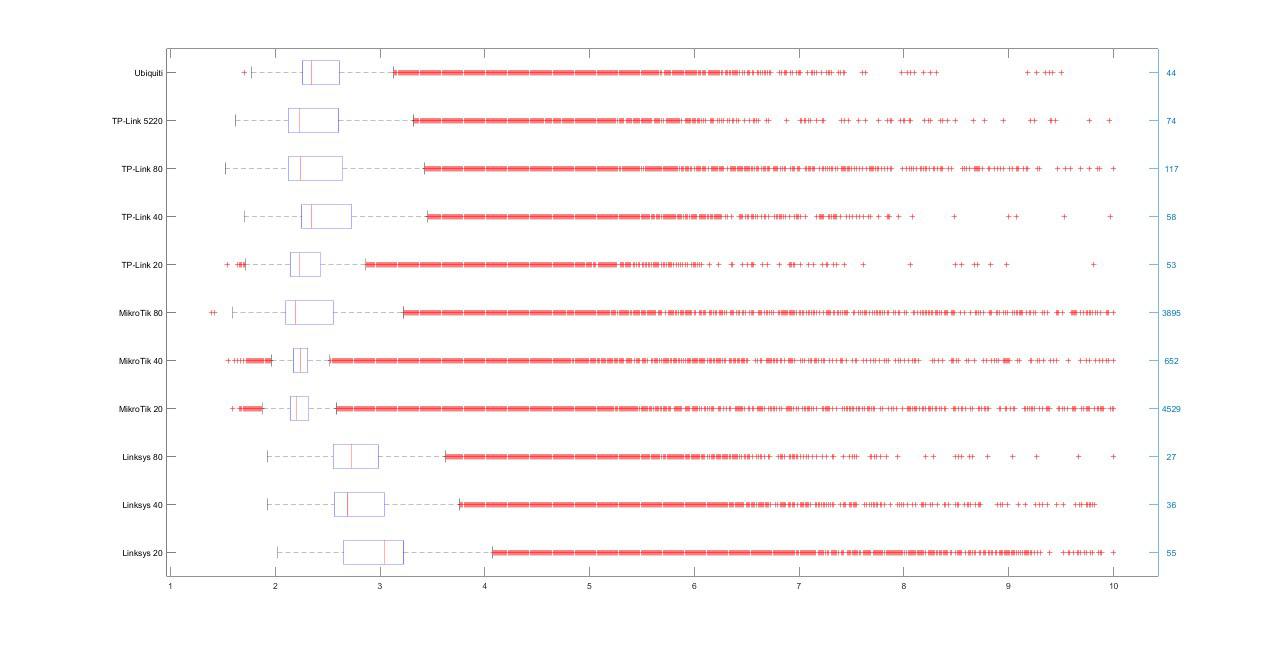

We observed very irregular frame-times within our application when using that router.
So we performed some tests and found out that it is related to this router.
Used settings: Channel 36 (5180MHz), 40MHz channel width (unless otherwise noted on the y-axis), ping return time using 10ms intervals, 60000 pings.
As you can see we get very nice ping response times for most of the packets.
But every few seconds we see return times >10ms (stated as count on the right hand side of the graphs).
This also happens using other products, but not even close in numbers.
I hope its just an issue with some settings in the router, but all that we tried didn’t work out.
Any suggestions?

How were you testing, as in what client in particular, and generating that graph?

May I know how to produce the picture that you shown? Also how to collect the readings using ping?
Many thanks.
YH

the plots where created with matlab by a colleague of mine, so i’m not 100% sure how he did it. PM me and i will see if i can provide the matlab file.
used linux ping for testing:
sudo ping x.x.x.x -i 0.01 -c 60000 | tee output.txt
you have to be root to perform ping with <0.1s intervals
Then stripped everything from the file except the response times
Setup was:
Laptop (Surface Book 2) - WiFi - Router - WiFi - Device
Ping is very nice since our application also relies on pretty small UDP packets, so it gives a good estimation of the overall performance in our case.

morph1,
Your graphs gives a lot of information to us. Would you mind to provide the model number of each plot such that we are all benefited.
Also I am very interested in interpreting the chart since I have not used MATLAB for a long time after leaving university. Could you please tell me how to read the plot or provide the link such that I can understand the meaning of your chart more.
