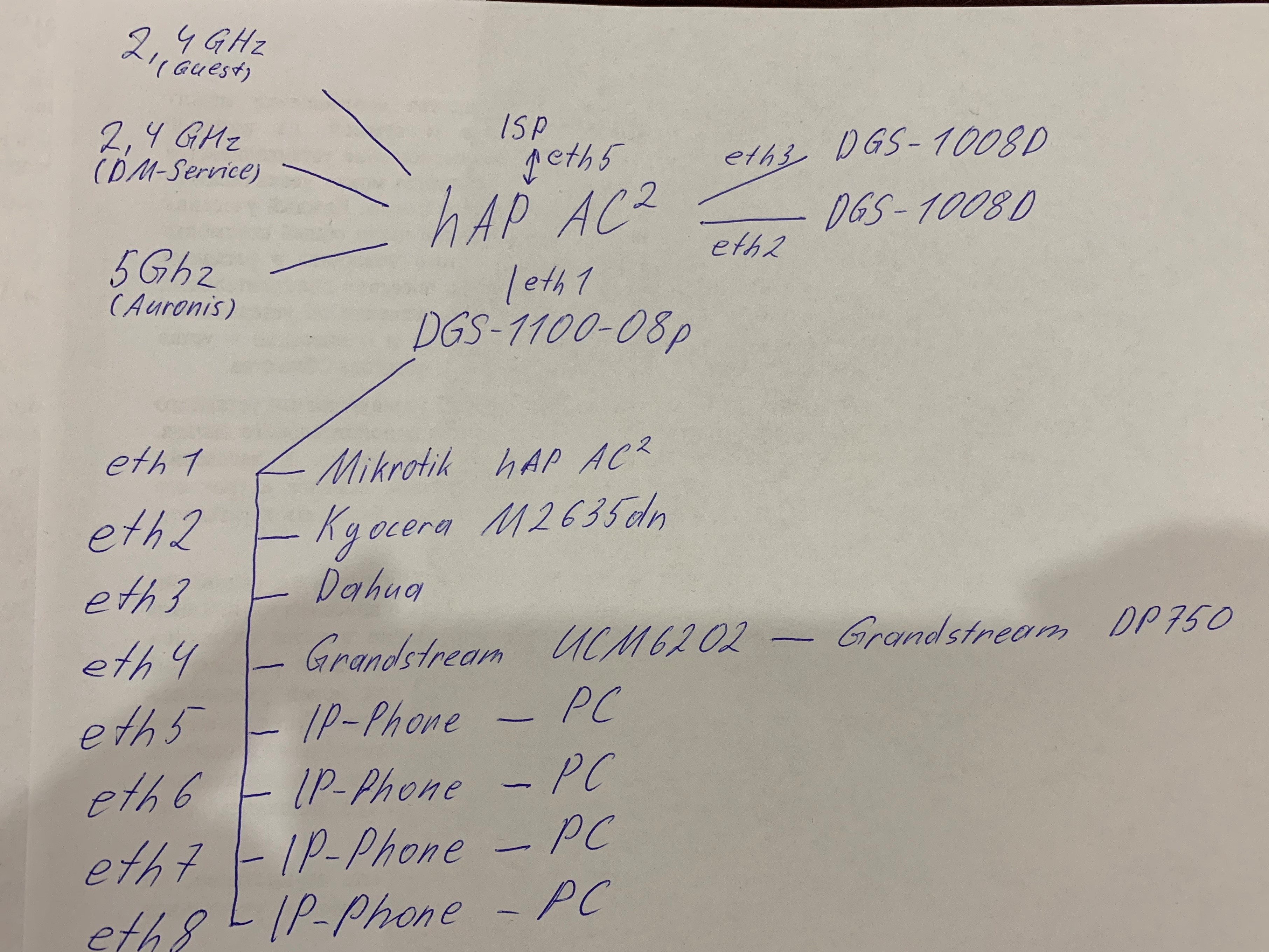

Basically I have:
hAP AC^2
D-Link DGS-1100-08P
I’ve set up the management VLAN on D-Link (VLAN 5) with the tagged port eth1 (to which hAP AC^2) is connected therefore now I can access D-Link’s web interface only through it’s eth1 by traffic tagged as VLAN 5.

Please post config of hap
/export hide-sensitive file=yourconfigtoday
Diagram would also be good.
Feel free to post config of dlink as well.
Greetings! I’ve attached config file & diagram of the network, unfortunately forum doesn’t allow to upload .bin config of the D-Link.
