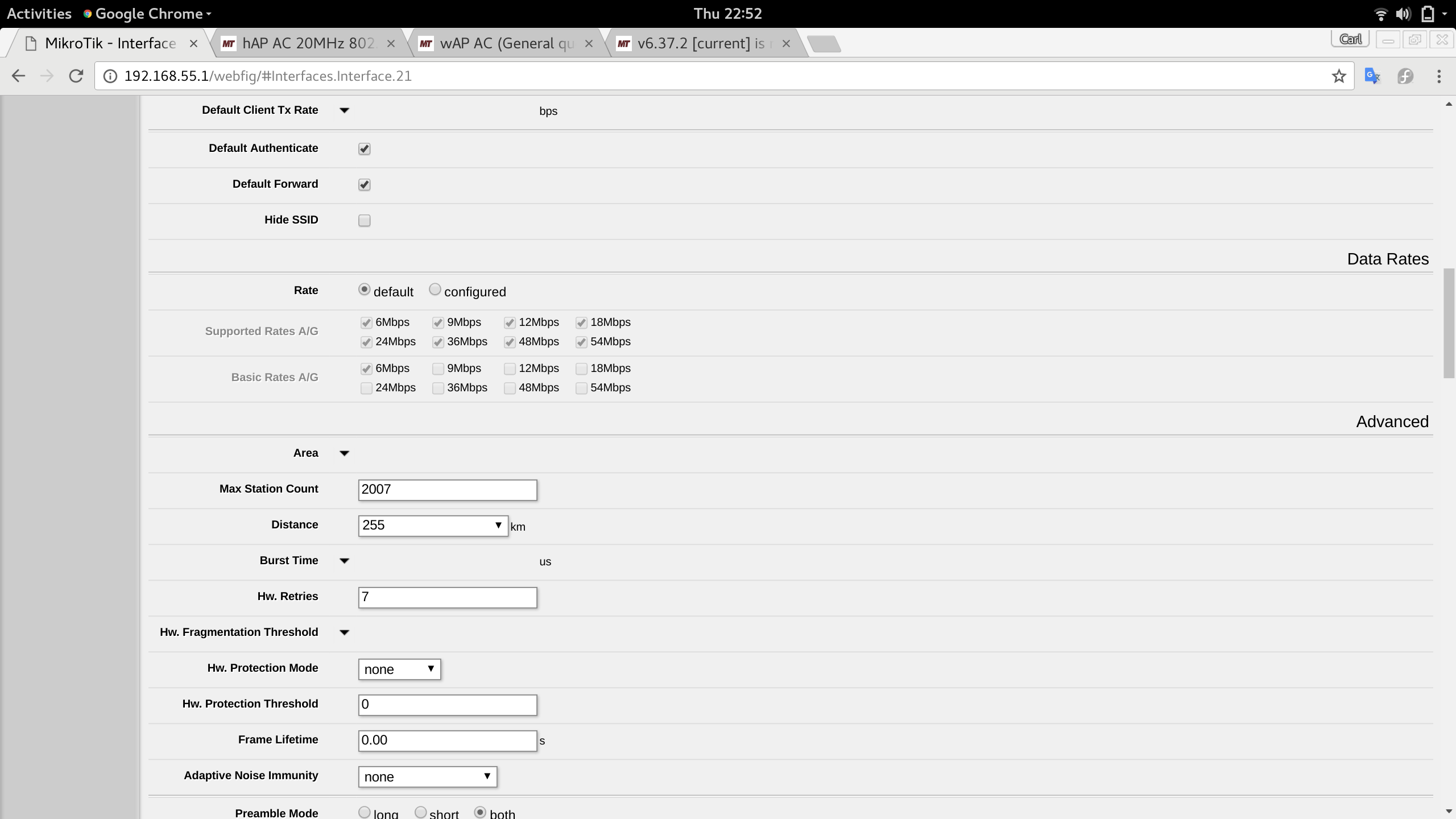

OK I found the problem, but I don’t know how it happened.
‘distance’ was set to 250Km.
I changed it to indoors, and all is well.
Any idea how this would change? chrome auto-fill cockup while using webmin? a bug during upgrade to -rc ?
Oh look, the 5GHz has almost the same weird setting! it says 255Km!!
I think the firmware upgrade has done this ?
What does ‘distance’ actually change anyway?
