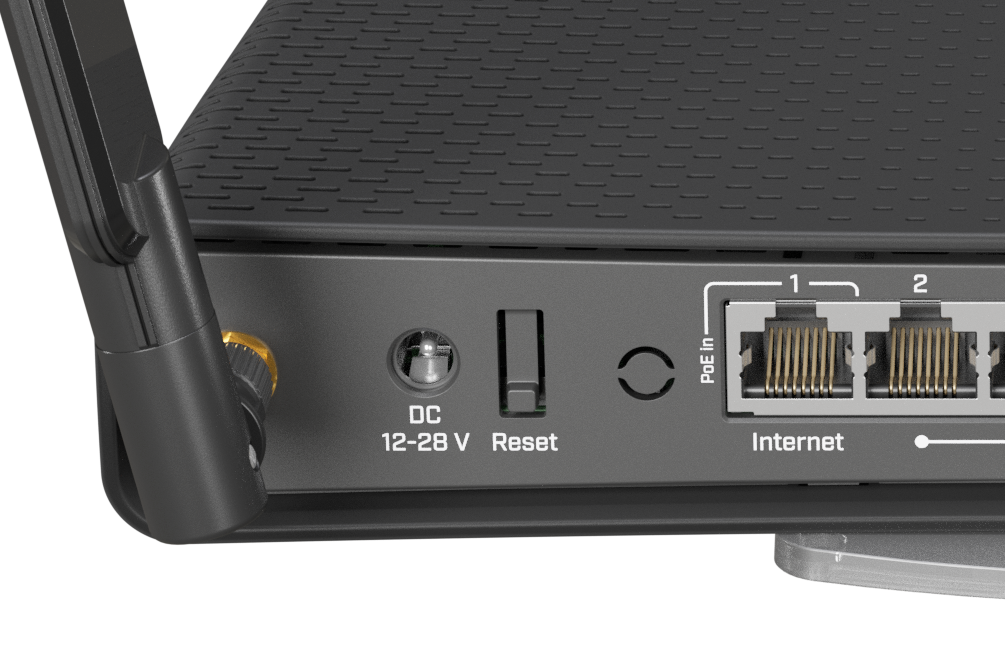

hint is on the port
EDIT: You can only use the provided injector. This device will not work from a TPLink switch. It does not have support for 802.3af/at, only Passive PoE
On port eth1 it says PoE In, so my assumption would be eth1.
Make sure you use passive PoE:
PoE in input Voltage 18-28 V
Mmm…I should refresh before posting…
:person_facepalming: thank you, so port 1 only. The router is mounted at height, and the ports are facing up, so couldn’t see that…

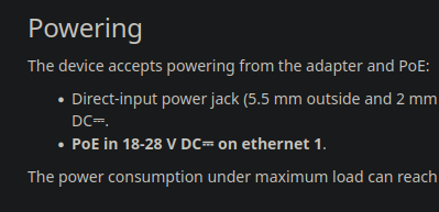

Wow, the doc got updated quickly! https://help.mikrotik.com/docs/display/UM/hAP+ac3#heading-Powering
It might be worth mentioning the lack of support for 802.3af/at, and the need to use the provided injector.

But what is stamped on the chassis is already there when you buy the device: PoE in on ether1 and DC 12-28V
But more than anything else it is you who should not make assumptions, if it is not written, it is not written!!!
