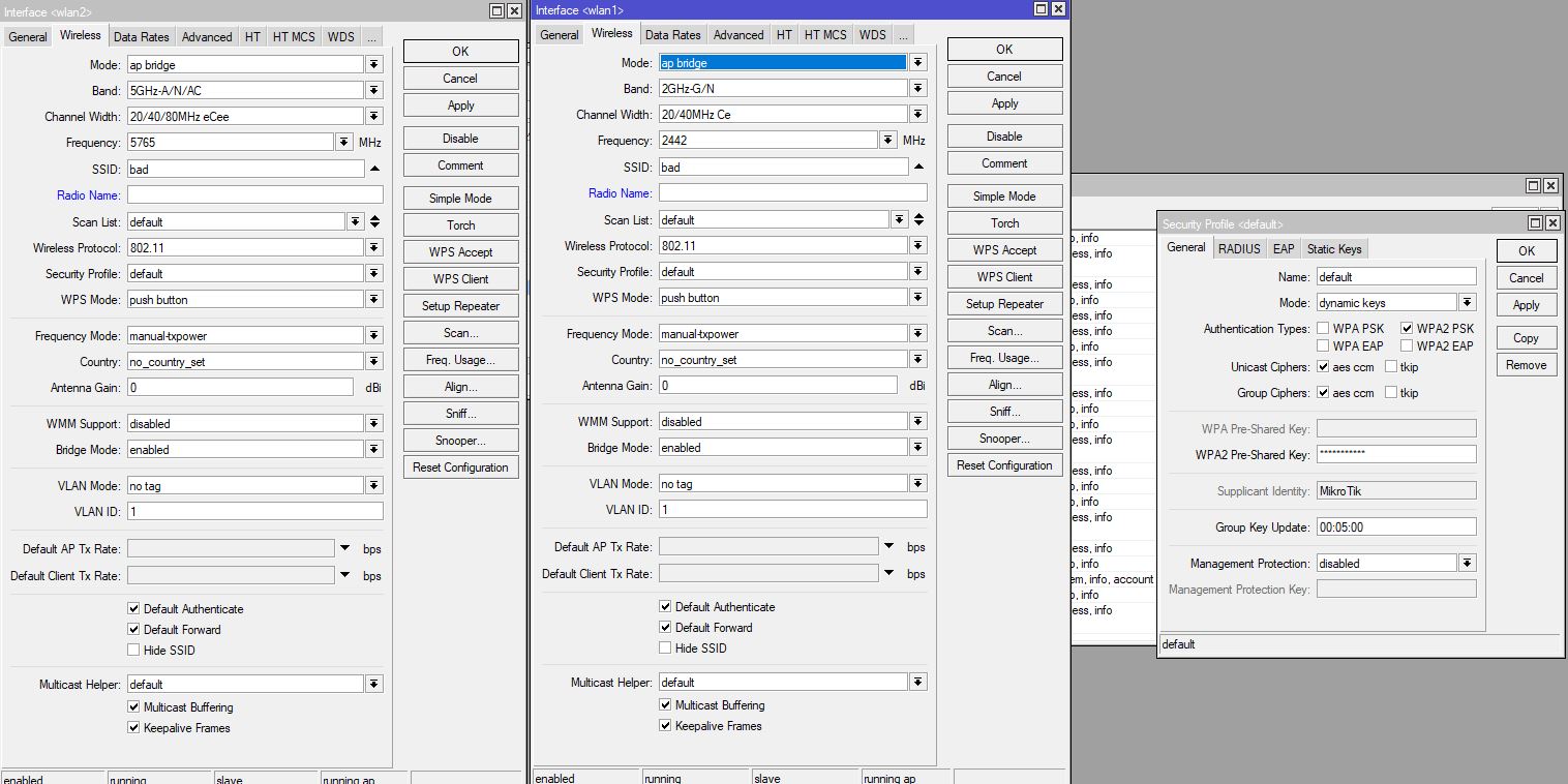

Recently, bought a hAP AC. I have three 5GHz enabled device at home (Htc One M7, Sony Xpeeria Z Ultra and Samsung S7 Edge). But, only the xperia phone is seeing the 5GHz ssid. Am I configured it wrong? I am attaching the configuration file. Any help will be highly appreciated.

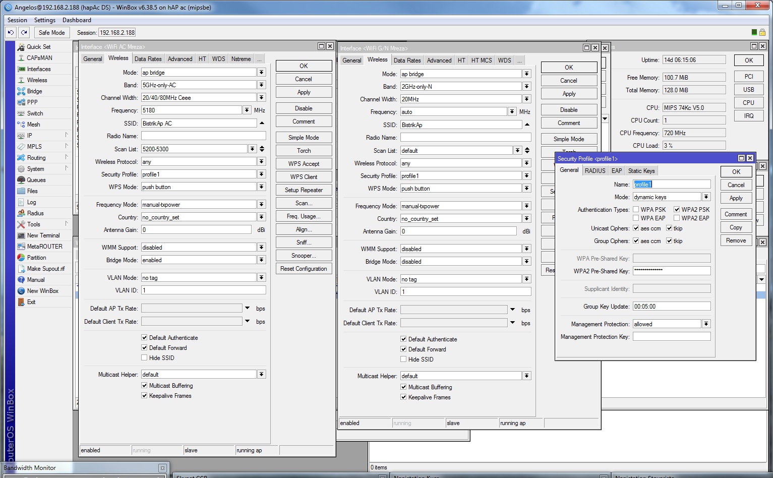

Try conf. from print screen. :slight_smile:

Thanks guys, solved the problem. By using "wifi analyzer’ from google play. Search for a 5 GHz ssid. At first I thought the problem is on my phone, but later found out some 5ghz band. Configured that way and it worked. @Angelos , saved the screenshot for later use, currently don’t have an iphone. @MartijnVdS , I disabled the tkip at the very beginning , I always use AES. And selected no countries in favor of more frequency’s. But, the problem I am currently facing is that I have frequent disconnect and connect of a single device.
