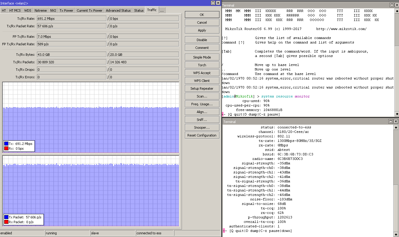

We did reach nearly 700Mbit, but that was inside an anechoic chamber with no outside interference, and with specific iperf3 settings. With normal conditions you should expect 500-600Mbit on 3 chains.
mind sharing your settings? I’ll see if I can lower my CPU consumption. I did my tests by copying large file between NAT on wired IF and my wifi client.

No special settings. Wlan1 in bridge with Ethernet
RouterOS 6.99 in 2017? Release 7 is near :laughing:
