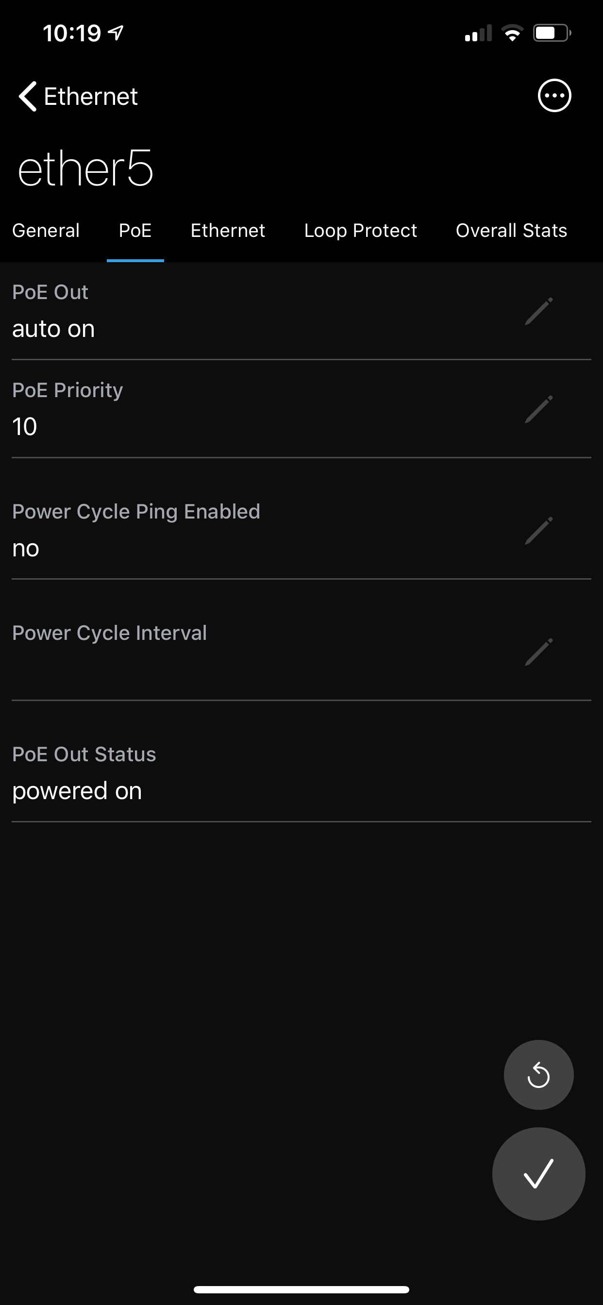

Please help. I’m connect my PoE IP camera in 5 port and camera don’t switch on. Not light green indicator on camera jack. I’m test this camera on PoE switch and camera worked correctly.
How to configure PoE?
