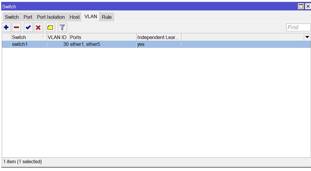

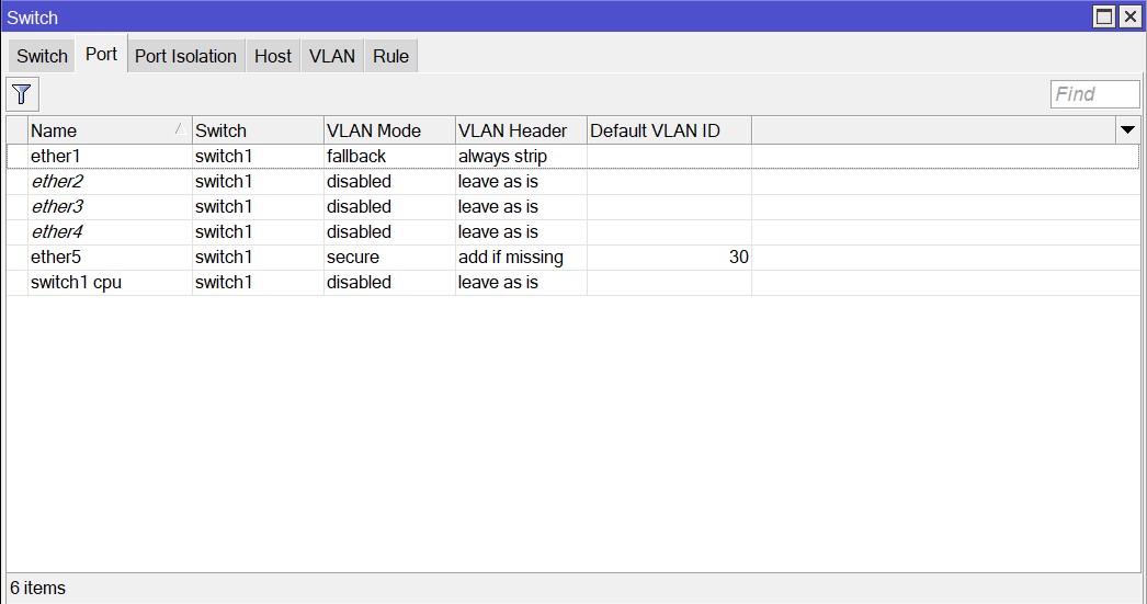

I had to play around with the definitions of Access and Trunk ports, but I got this to work. The device I want to be on VLAN 30 is connected to ether5. The port leading to my local LAN and router Ether1. Please see the images below.
I set this up on the hAP ac and it worked well. The instruction in the above link state that a similar configuration should work on an RB951. The 951 switch chip should be capable of doing this. I tried configuring a 951 from scratch, but could not get it to work.
Can anyone explain the two experiments I did? The hAP ac DOES work. Did I just get lucky?
Thanks for your advice.
