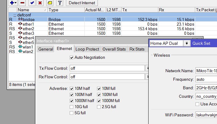

  • does your Ether1 really advertise 1000M rate? (based on your screenshot, it should, but still, check reality on “Status” tab)
  • does your Ether1 link partner also advertise 1000M rate? (again check it on “Status” tab of interface)
  • If both advertise 1000M rate, but you still see only 100M rate active, it means the communication was not stable on 1000M → cable problem again…
