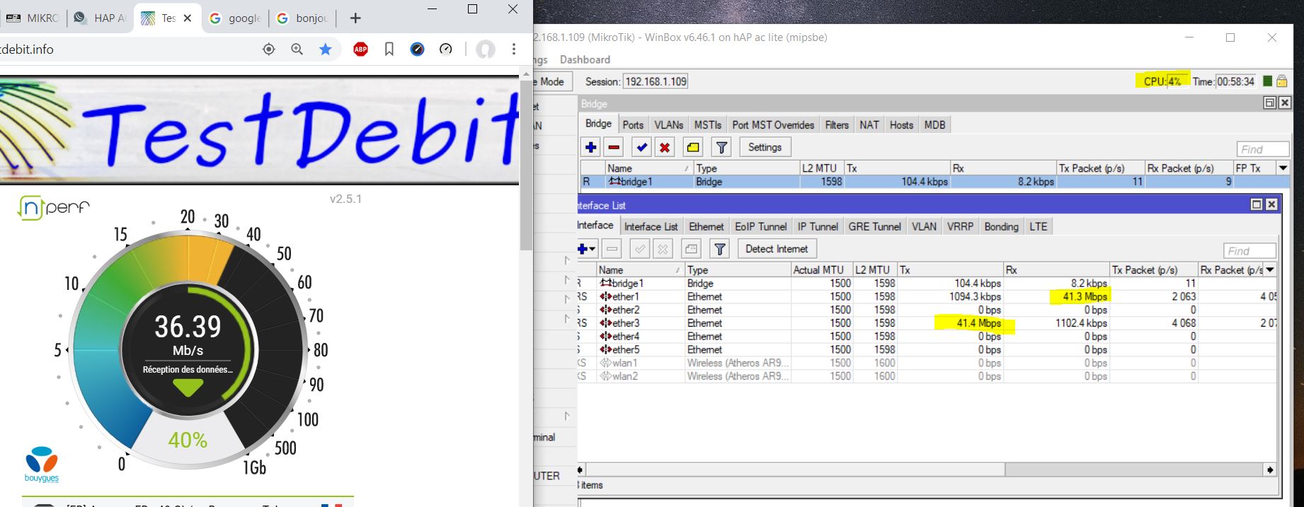

after several test, i assume is due to the performance of HAP AC lite
here’s my test :
configuration for all device nothing else but :
reset configuration with no default configuration
setup a bridge with all ports
dhcp clients on the brigde
all test via ethernet
huawei modem b715s : speedtest : 120Mb down/20 Mb up
just an ethernet cable between huawei and :
Audience 6.41 = great i loose nothing
HAP AC2 6.41 = great i loose nothing
HAP AC LITE 6.41 = i loose between 50 to 70% of my bandwidth down (around 40Mb)

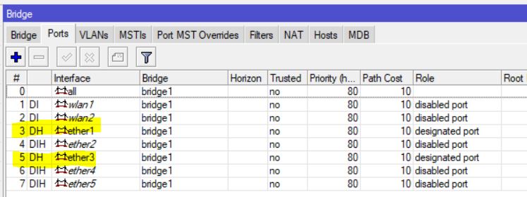

On your mtik - what speed do you see in ethernet ports status, is it 100 Mbps Full Duplex ? Is Hw. Offload activated on bridge ports (look at Bridge/Ports for big H next to port numbers) ?
i confirm all are on 100Mb/s full duplex (huawei → hapac lite and hapac lite → mypc)
The speedtest is made by several speedtest online like www.speedtest.net or other
i confirm all is on 100Mbs full duplex and HW offload activated

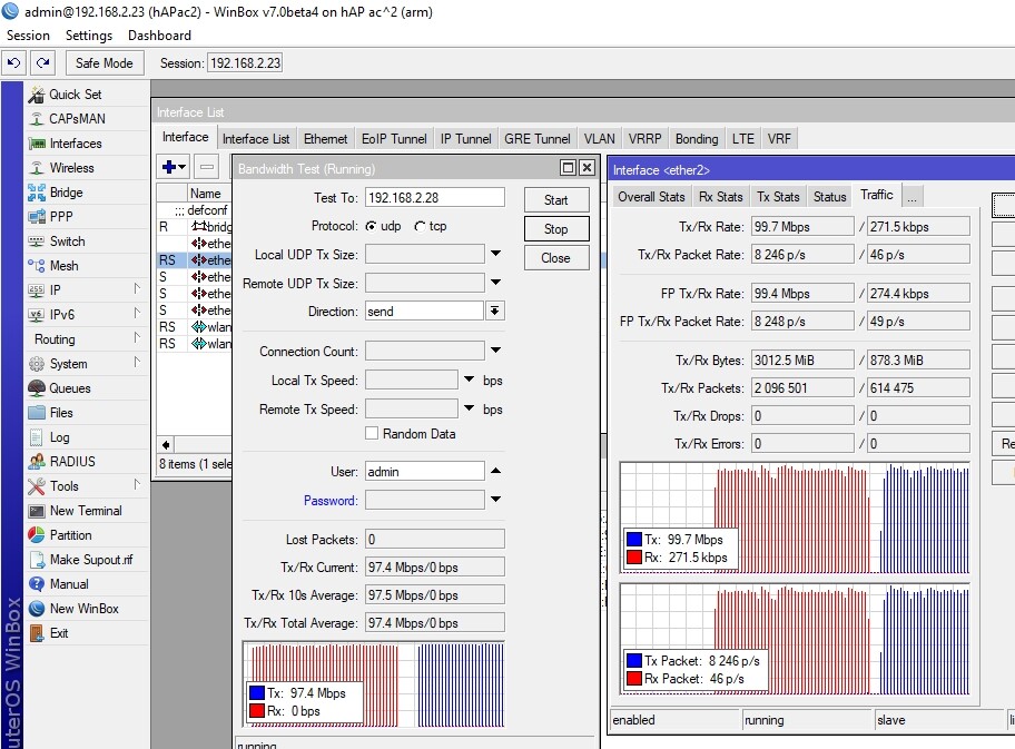

Yes it is because of performance of hAP AC Lite, look ate the picture below! With 40-45 Mbps it goes to 95-100% Processor usage! So cannot support more traffic! I have more than 80 of those routers and is the same thing! I use this for clients that need under 20Mbps and need WiFi just for small areas!
I understand but i don’t verify what’s you say
It looks like you are running btest TO the device in the image. If so, you are also measuring the CPU eaten up by the btest processes.
Run btest THROUGH this device, using two unrelated units, and you should see this greatly improve.
Correct… He tests it in a wrong way…
I’ve tested in both ways and is the same thing! Btest processes not use more than 5% of processor all other is used by networking! That device stays 1-6% of processor usage just doing nothing!

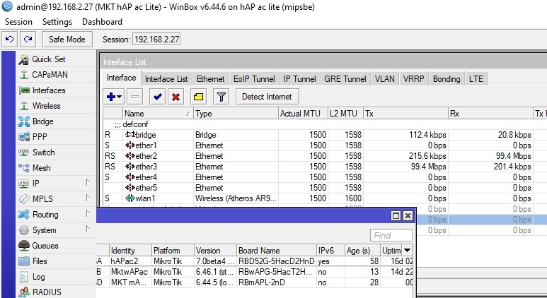

My little quick and dirty test setup (ROS versions different and taken off a WLAN-ptp network)
I connected a “hAPac2” - to -" hAP ac Lite" - to - “mAP Lite”. Connection from hAP ac2 to mAP Lite passes over the hAP ac Lite switch.
Only the hAP ac2 has 1Gbps interfaces.
My simple test shows me full speed in all directions.
