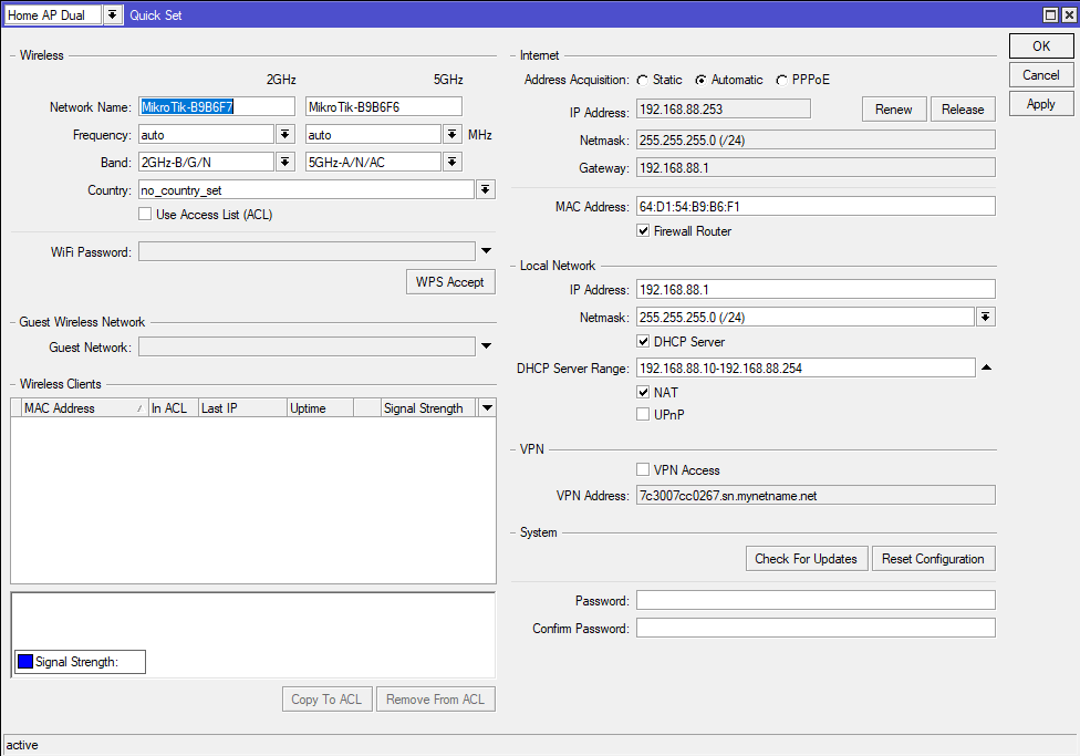

I tried to configure my connection with Quick Set to use my hAP ac lite as bridge to existing net connection with SXT Lite5. Can abybody help me to go through the steps how to set up my connection?
Internet gateway and my local IP can be the same?
Thank you.
First of all, your gateway address is EXACTLY the same, as the address of your SXT (192.168.88.1). I don’t know if you have the access to SXT device, but teoretically you have 2 ways to go. However, I will stick with 1, where you have NAT on you hAP ac lite.
Let hAP get address from SXT as it already did (192.168.88.253) but you need to change local network to something different than 192.168.88.0/24. You can assign the address like 192.168.100.1, network 192.168.100.0/24, change DHCP, pools etc.
