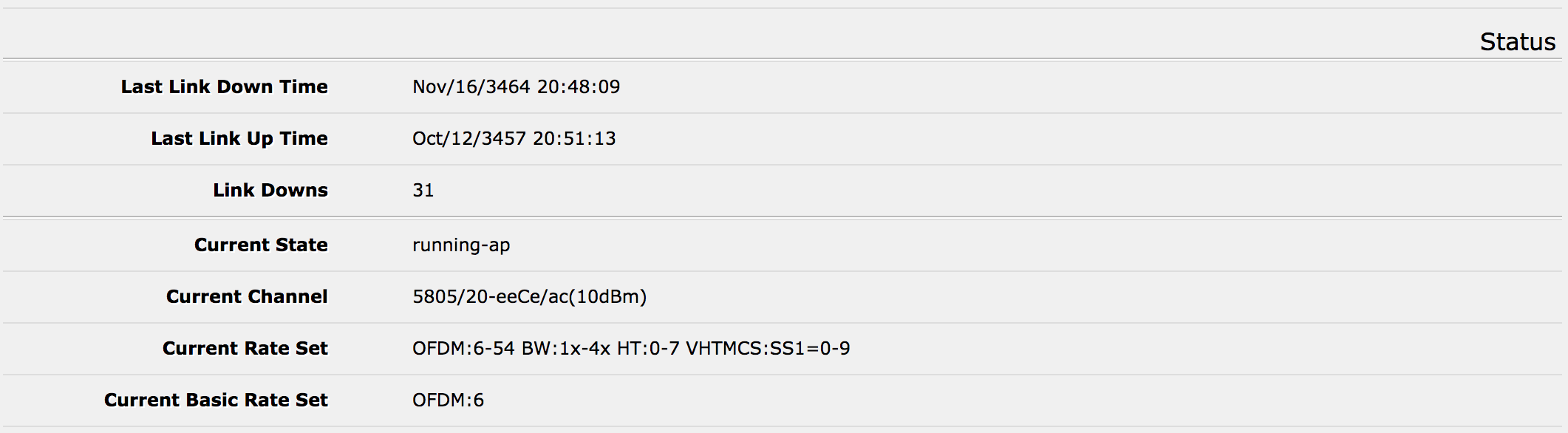

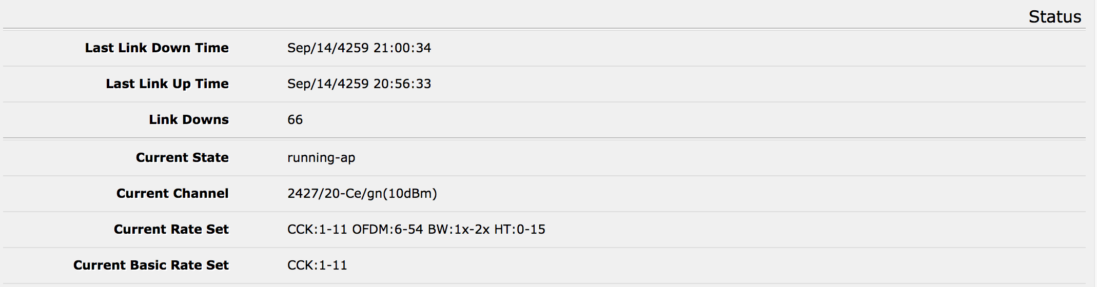

The interface runs in 2427/20-Ce/gn(10dBm) and 5805/20-eeCe/ac(10dBm)

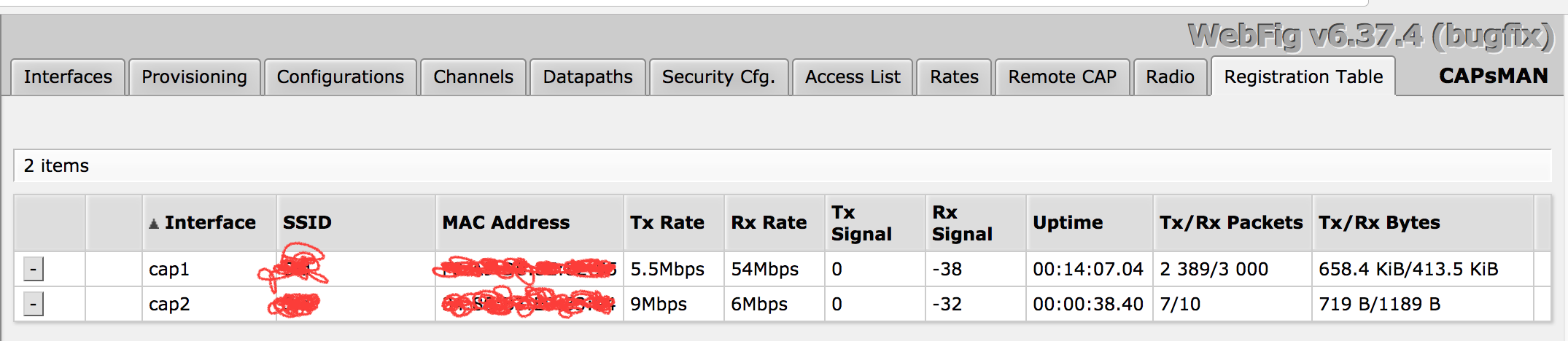

The connected device always works at 54Mbps

I also try force specify the ‘width’ in configuration, ROS report errors e.g. ‘band not supported’ or ‘channel not supported’, and failed to enable the interface.
I also try specified ‘Ce’ or ‘Ceee’ or other combinations for ‘Extension Channel’, or limit to ‘2ghz-g/n’ ‘5ghz-onlyac’ ‘5ghz-onlyn’, still can’t enable wider bandwidth
Am I missing something ? And how can I enable the 20/40MHz for 2G band, and 40/80MHz for 5G band ?
