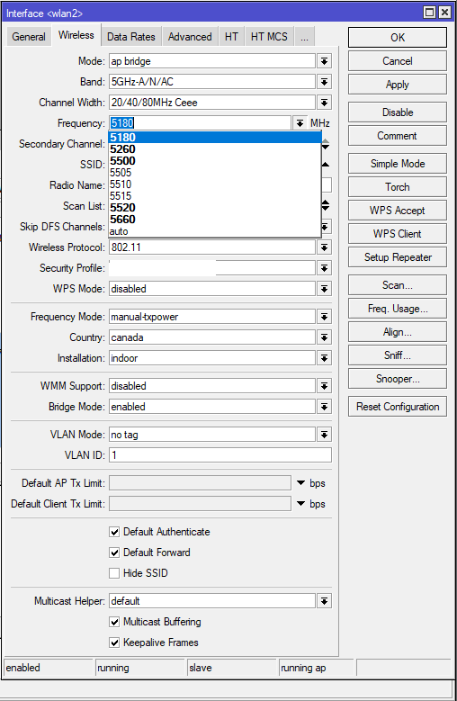

hAP AC Lite - Missing a lot of channel
I deployed a few hAP AC Lite to replace our airCube.
So far it’s going well but there is still a few issues.
One of them is that it’s not possible to chose proper 5G channel.
I’m in Canada and I this is the only channel that are available.
I know that this device doesn’t support DFS but I should be able to have at least the basic channel.
Am I missing something?

Anybody have a clue?
Yes, choosing different channel extension pattern.
… and a smaller bandwidth. max 40 MHz should be ample.
I did try with 40MHz, there is more channel available, but not all of them.
I’m still trying to figure out what is going on.
Your channel width is “Ceee”, experiment with that. Try eeeC or such.
@Normis: wouldn’t channel width set to “XXXX” allow greatest selection of possible frequency channels?
The wider the bandwidth, the less of channels to choose from. I think this explains it:
And, please never choose XXXX, just select the correct channel and the correct extension channels manually.
Nice chart. But doesn't explain the part of your closing sentence I highlited. What is proper selection for e.g. channel between 5170MHz and 5250 MHz? Is it Ceee@5180 or is it eCee@5200 or eeCe@5220 or eeeC@5240?

Don’t use installation “indoor”. Use installation “any” if it is indoors. This will include the outdoor allowed frequencies
Mikrotik misunderstood the rules. There are no “outdoor only” frequencies, there are “indoor only” and “also allowed outdoor” frequencies. You are free to use the frequencies labeled “outdoor” in the Mikrotik list if operating indoors. There is no risk of breaking the rules.

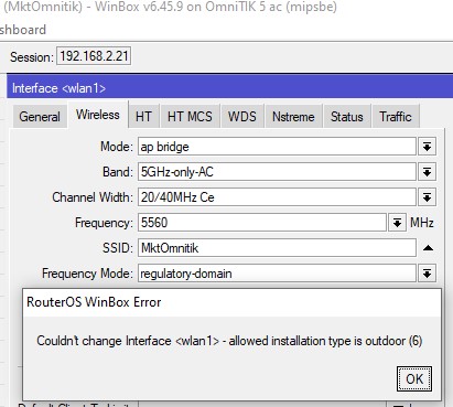

Not entirely correct. “indoor only” mode is for outdoor type devices.
Basically you should only change this option if you have an outdoor type waterproof device. For home AP devices, always leave “any”.
Indeed not fully correct: “indoor” in some cases cannot be set on typical outdoor devices (SXTsq ac, Omnitik ac …) to my frustration for the Omnitik ac (makes not much sense for the SXTsq in regular use). I’m glad you still allow it for the wAP ac !! And “indoor” setting here also makes no sense, leave it on “any”.
Leave on “any”, yes fully agree, but so many users are confused and set it on “indoor” if used indoors.

Omnitik AC cannot use “indoor” or “any” installation type. So cannot use indoor frequencies.
And this is correct. Omnitik can’t be used indoors, and can’t use indoor frequencies outdoors.
Which particular property of Omnitik makes it impossible to be used indoor?
Omnitik is too powerful and so it can’t be certified for indoor use, as the power can’t be sufficiently reduced to pass regulatory tests.

Too powerful ??? Not powerful at all. It will stick to the legal EIRP requirements of the regulator. With its 8 dBi antenna this means the radio power is lower, and the overall transmitted power is lower than a near isotropic antenna. Practical experience is that the Omnitik ac does not pass wall’s and ceilings very well, even taking into account it’s radiation pattern. In practice a wAP ac passes those obstacles much better, when using the same frequency and the same EIRP, it’s overall TXpower of the wAP ac is 6dB higher.
“can’t be certified for indoor use, as the power can’t be sufficiently reduced to pass regulatory tests.” … challenge your Certification officer! What is going on here? I have no knowledge of regulations that set a lower limit on indoor usage than outdoor usage (https://wlan1nde.wordpress.com/2014/11/26/wlan-maximum-transmission-power-etsi/). It are all the same values. And the radio power can be reduced to 2dBm like any other radio. With 8 dBi antenna gain this is 10dBm EIRP. Even my laptop delivers more. Why did you fail the test? There must be some other reason. It could be a reasonable marketing decision, Would be a legitimate decision anyway.
“Cannot be used indoor” ??? Never seen that instruction. So we use it indoor with also outdoor allowed frequencies at 27dBm EIRP. And still, people trying to set up some self-made backhaul network at home to their hAP ac2’s are disappointed. And using the Omnitik ac will not be an improvement.
… Disabled the WLAN interface … and using it as a RouterOS testbox
Sorry, wording was not correct.
Omnitik is “not certified” to be used in those frequencies. However, it is certified to be used indoors with the setting “outdoor” .
Also please clarify which omnitik, there are several and their behavior/certification is not the same
OmniTik isn’t meant to be used and isn’t certified for frequencies 5150 - 5250 MHz; 5250 - 5350 MHz which are indoor use only, but you can freely use 5470 - 5725 MHz frequencies indoors with the setting “outdoor”. This will be ok with regulatory requirements.
