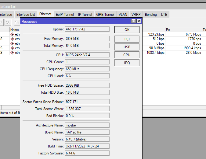

ROS 6. I do recall upgrading one of these to ROS 7 last year - they are experimental devices for me after all. I spotted that it ran visibly slower, e.g. doing a /export. I rolled them back to ROS 6 as this is what most of my clients are still running with a note to re-visit again.

I tested wired and wireless. The Wi-Fi 5 speed was limited to about the same speed (60Mbps). From memory, the lites only have only chain on Wi-Fi 5 so that’s got a theoretical speed of ~450Mbps (?) but even that should translate on to nearly 100Mbps. The fact the wireless speed and Wi-Fi 5 speeds have the same maximum suggests it’s either a limitation of the hAP lite, bug or configuration problem.
Both tests will be downloading through ether1 either in router or switch mode. As it occurred on both a hAP ac lite and hAP lite suggests it’s not a faulty device. I’ll connect my desktop computer and Raspberry Pi later.
I’ll upgrade them to ROS 7 as a test as well.
