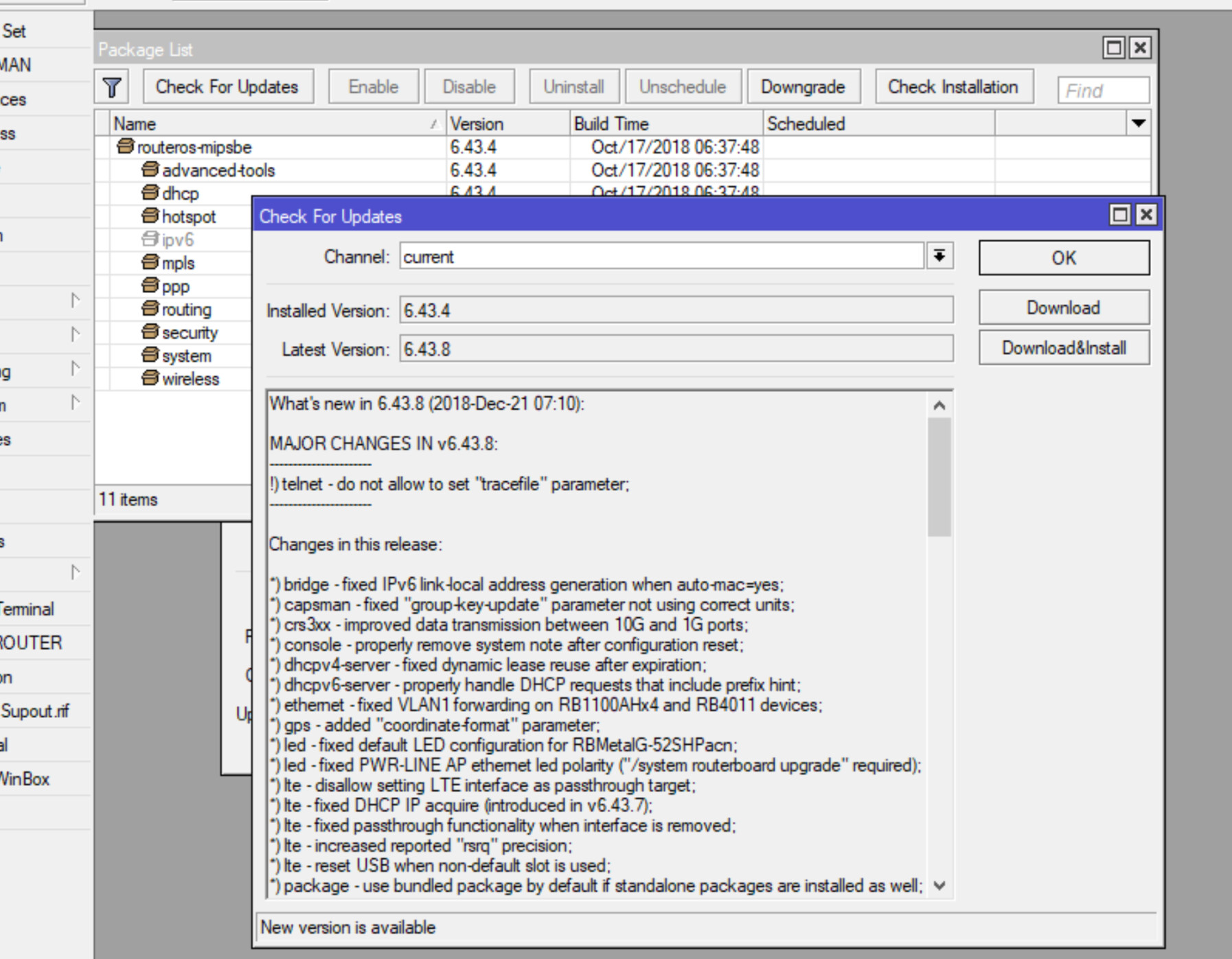

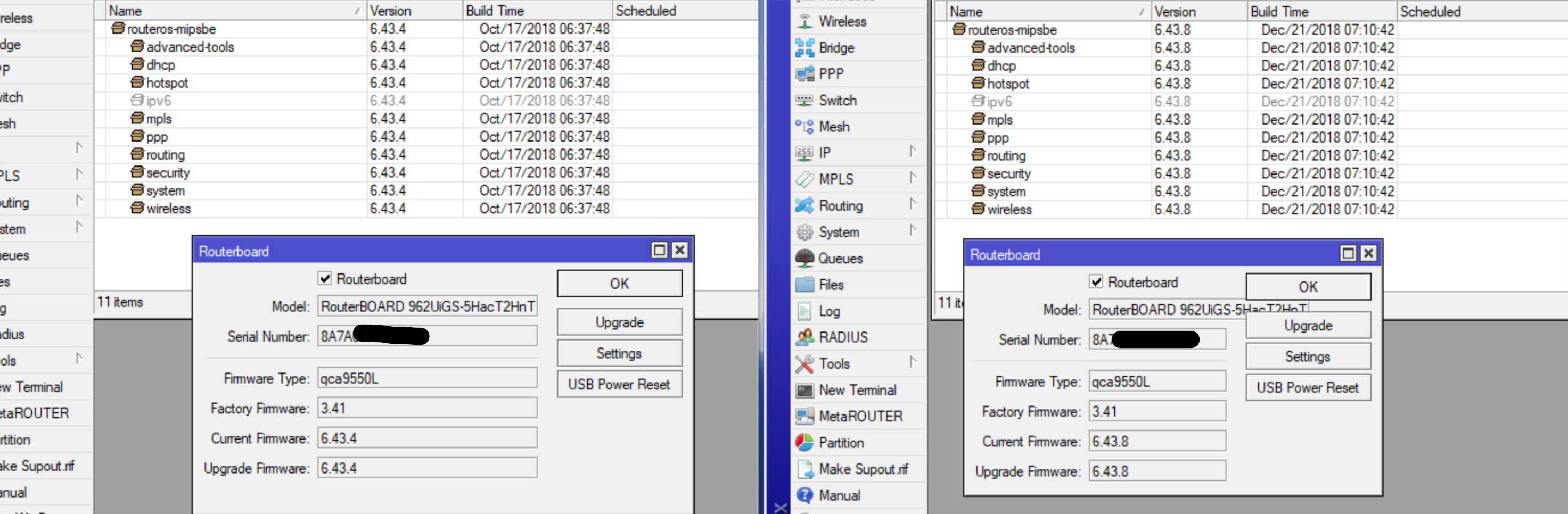

Guys. i have 2 hAP AC routers, please check the pictures here..

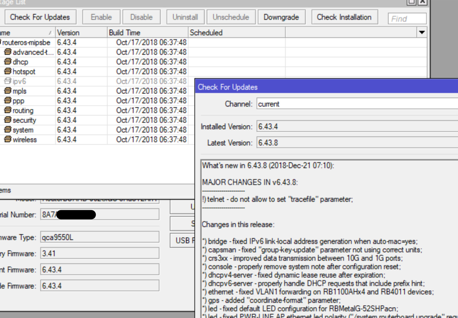

The one on the left side does not want to update. The one on the right updated without glitches after a few clicks and reboots.
I am still learning about the features on these wonderful devices. is there anything i am missing here or that i can try? or i got a faulty unit?

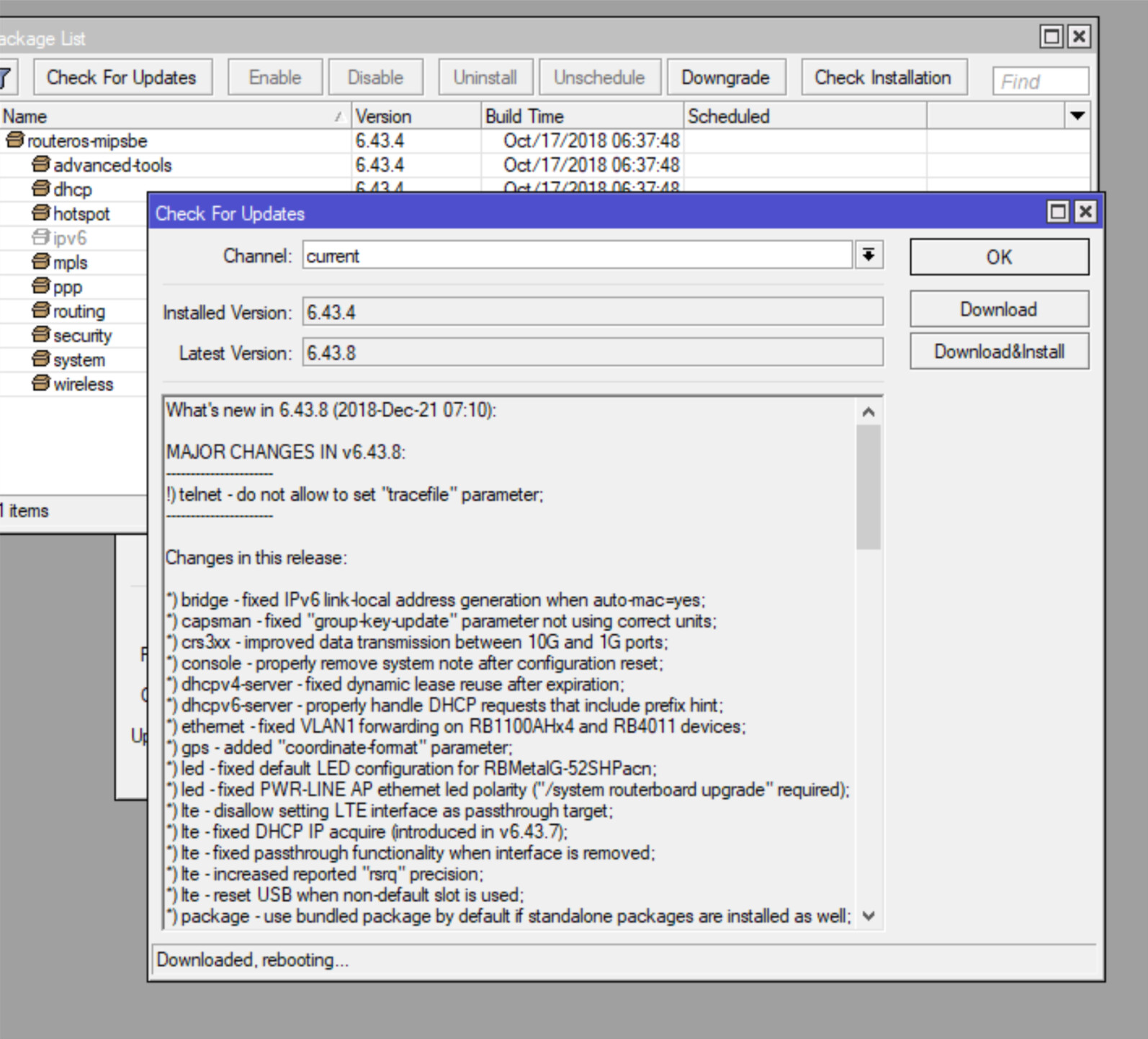

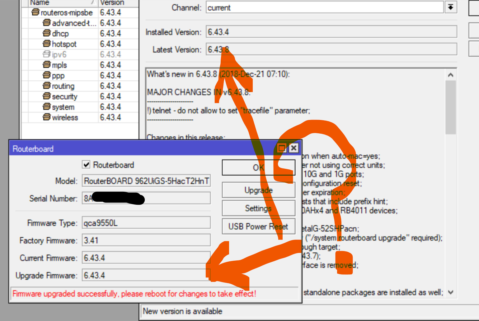

I tried upgrading and rebooting in so many different ways, still get the 6.43.4 no matter what.
You re mixing RouteOS update and Firmware upgrade. These are 2 different things.
Press the Download&Install button in Check For Updates window to update RouterOS.
After reboot you can press Upgrade button in Routerboard window to upgrade also the firmware.
