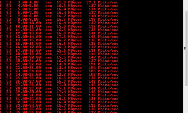

HAP ac RB962UiGS-5HacT2HnT - client1<->AP<->client2 no more 150Mbit speed iperf3
Hello all.

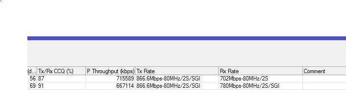

I’ve got next scheme:
HAP ac - is using as Wi-Fi router only (only IP address for mgmt)
Client1<->AP(wlan2-5)<->Client2 - all of them located on the table distance 0.5m
Both of the clients have 2*2 MIMO.
I’ve tried different regulatory-domain, as well different 5GHz settings.

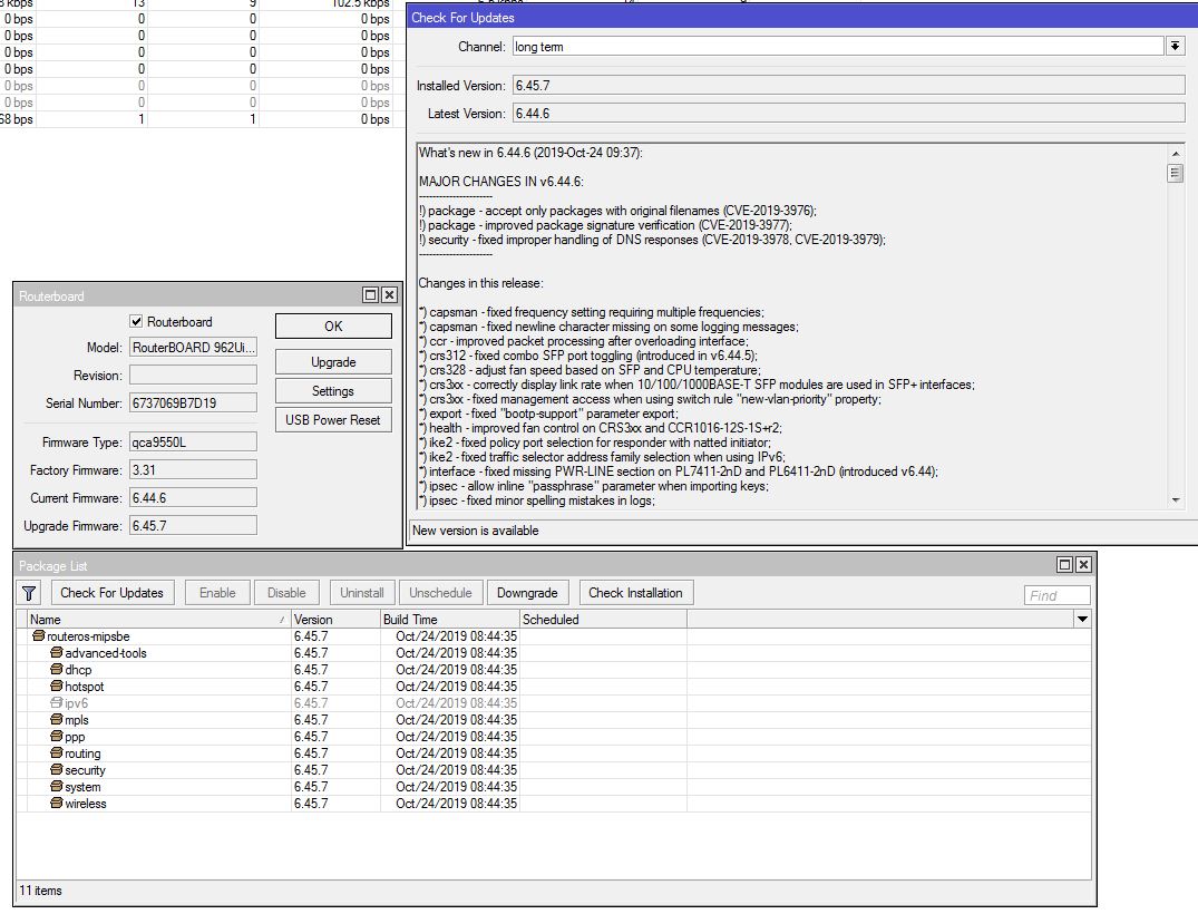

Also tried version 6.44.6 (long-term) & 6.45.7
But speed <= 150 mbit
PFA a lot of screenshots.

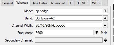

 1  R name="wlan2" mtu=1500 l2mtu=1600 mac-address=6C:3B:6B:12:12:B6 arp=enabled disable-running-check=no interface-type=Atheros AR9888 radio-name="6C3B6B1212B6" mode=ap-bridge ssid="5" area="" frequency-mode=regulatory-domain country=russia
      installation=indoor antenna-gain=0 frequency=auto band=5ghz-onlyac channel-width=20/40/80mhz-XXXX secondary-channel="" scan-list=default wireless-protocol=802.11 rate-set=default
      supported-rates-a/g=6Mbps,9Mbps,12Mbps,18Mbps,24Mbps,36Mbps,48Mbps,54Mbps basic-rates-a/g=6Mbps max-station-count=50 distance=indoors tx-power-mode=default vlan-mode=use-tag vlan-id=105 wds-mode=disabled wds-default-bridge=none
      wds-default-cost=100 wds-cost-range=50-150 wds-ignore-ssid=no update-stats-interval=disabled bridge-mode=enabled default-authentication=yes default-forwarding=yes default-ap-tx-limit=0 default-client-tx-limit=0 wmm-support=enabled hide-ssid=no
      security-profile=profile2_5GHz wps-mode=disabled station-roaming=enabled disconnect-timeout=10s on-fail-retry-time=1s preamble-mode=both compression=no allow-sharedkey=no station-bridge-clone-mac=00:00:00:00:00:00 ampdu-priorities=0
      guard-interval=any ht-supported-mcs=mcs-0,mcs-1,mcs-2,mcs-3,mcs-4,mcs-5,mcs-6,mcs-7,mcs-8,mcs-9,mcs-10,mcs-11,mcs-12,mcs-13,mcs-14,mcs-15,mcs-16,mcs-17,mcs-18,mcs-19,mcs-20,mcs-21,mcs-22,mcs-23
Could anyone check my settings and correct if I missed anything please?
Thank you.

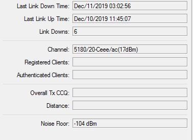

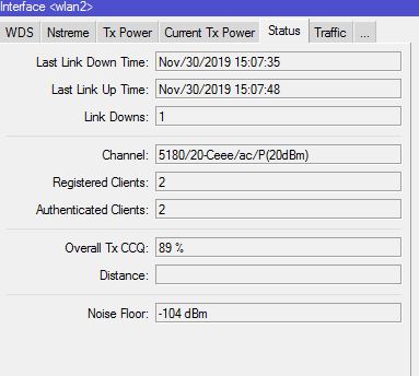

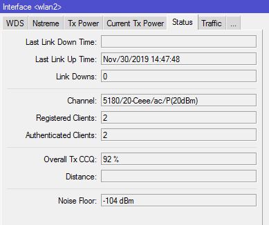

Well, as i can see only 20 MHz channel width is used which makes that speed pretty normal… I guess your client devices do not support greater channel width ? Am not sure if thats the case though…
You could play with the VHT rates, you could try another frequency and lastly, no need to have the clients so close to the AP…
Thanks for your answer.
In my case I turn off/on Wi-Fi and had 20MHz wifi
Both of my devices had ac support (you can check my post) intell wi-fi card 22 and second one is OnePlus6 phone with 22 MIMO support.
What can I test more?
Some ideas?
Thank you.

In addition, I would always use fixed channels.

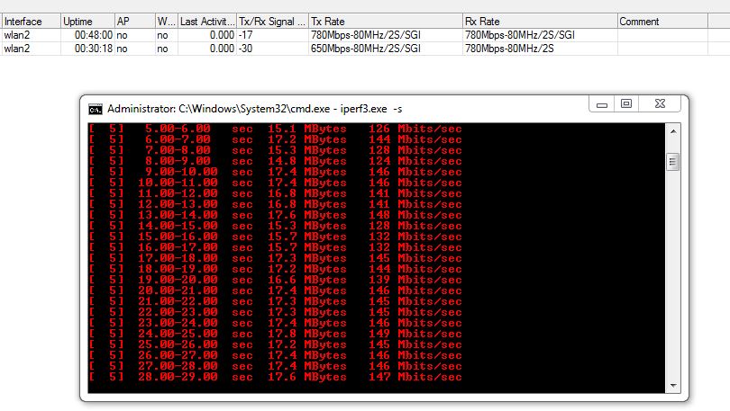

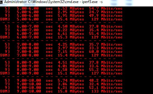

I tested with multiple streams & single stream as well (TCP & UDP). Made a screenshot of CPU when I tested Wi-Fi speed.
I know that wireless doesn’t equal wire.
But for both of devices which have 2*2 I expected up to 500Mbit
I bought HAP ac hardware to get not 150Mbit/s (for this speed I have my previous Wi-Fi)
I tested with FTP, copy files and also iperf = same result.
The most confusing thing that AP shows that this devices can utilized bandwidth.

Static channel doesn’t help.

I think you have 2 problems with your setup:
  • You test the hap ac2 with 2 connected wireless, which splits your bandwidth, so 150Mbit is in fact 150Mbit IN and 150Mbit OUT from hap ac2 all on same channel
  • all wireless devices located so close together are making a lot more noise = lost bandwidth.
  • From what I know, the default iperf packet size is small (16bytes?) and all networking will benefit using a larger packet size, let’s say 512 bytes or 64 bytes as in https://mikrotik.com/product/hap_ac2#fndtn-testresults
You should make the test between wireless and cable to see a result not influenced that much by the interference of the other devices.
If your use scenario does involve transferring data over two or more wireless devices connected with a hap ac2 in the real world, then start from the maximum THEORETICAL throughput of all devices and will have about 25% to 30% in good conditions. So if you want 500Mbit between two wireless devices connected to an ap, you should have ALL devices with support for 1300Mbit over wireless. You have 867Mhz Intel so you should expect about max 300Mbit not 500Mbit in real life.
Could you please tell me, how can you configured “40MHz channel width”. Can I do it manually?
Thank you for reply
