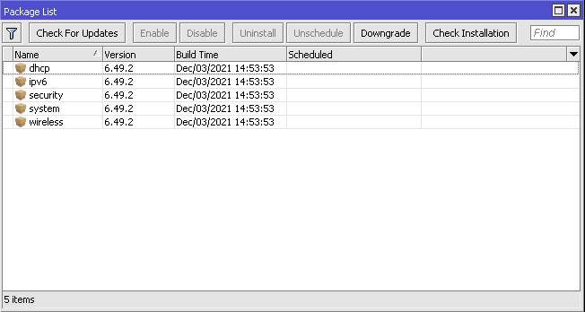

Did you “unbundle” installation of ROS v6 on this device? ROS v7 comes as bundled installation but unbundled install can not be bundled again. Netinstall is your friend … or so they say.
Yes, I did unbundled install as these devices have very little flash available and I wanted to be conservative on space wasted.

The problem with unbundling is that upgrade process tries to find upgrade candidates for all upgrade packages … if new version comes with all needed packages, then this is not a problem. If new version lacks some packages (in case of ROS v7 that’s most of packages), this becomes a problem. Unbundling was never officially supported nor encouraged. So I guess MT isn’t keen on supporting it either.

Also since RouterOS v7 beta was first released back in September 2019 it has been known that the ability to install the individual packages (system, wireless, dhcp, etc) is gone and everything is in one monolithic package, only making upgrades easy from the v6 bundle package, unless the device has a lot of free space. If you set up your hap ac2 two years ago, that was after it was common knowledge that MikroTik was doing this with v7.

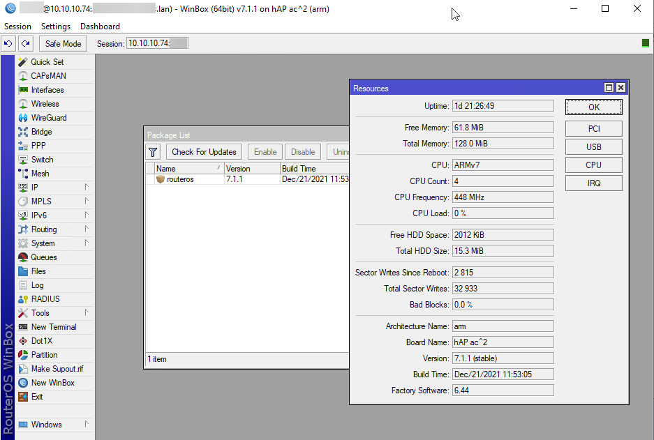

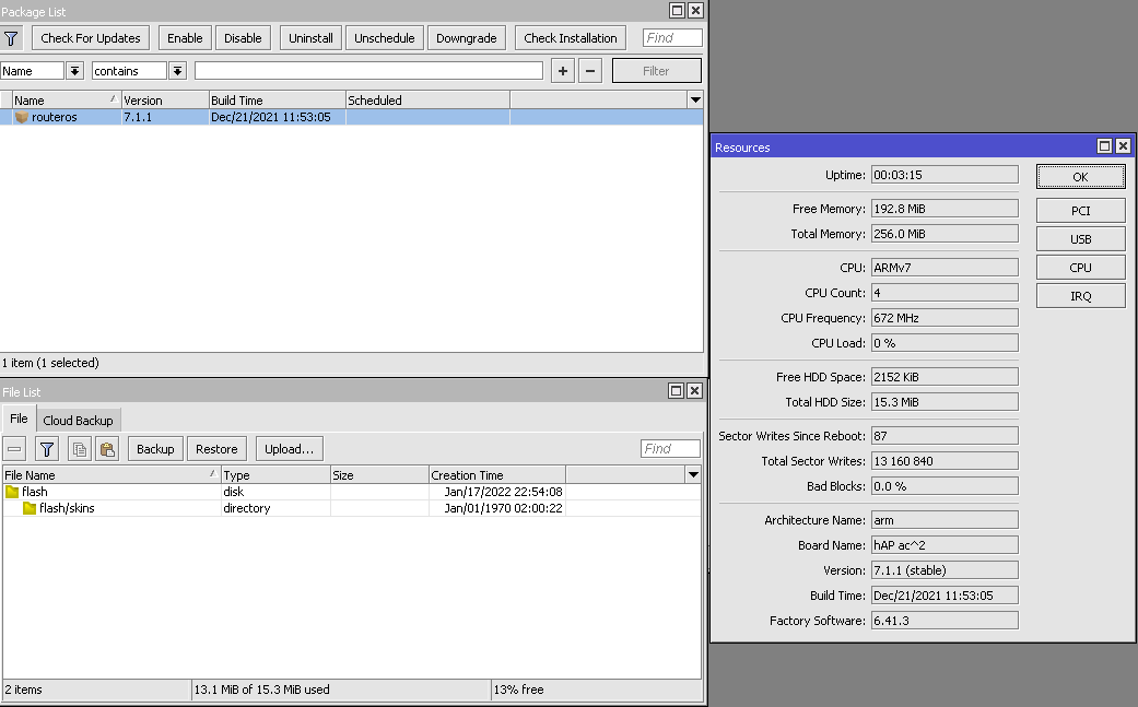

Actually this worked… :smiley:
And after that I simply restored binary backup (which I made prior), to get wireless and ipv6 config back.
