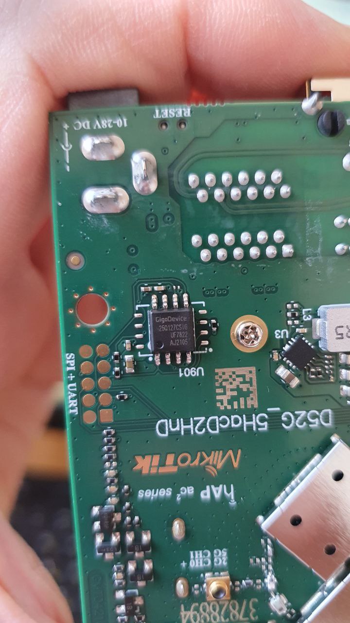

Hi everyone! After the system update, I was faced with the inability to boot the device.
I ran the following to try and recover the device:
  1. I tried to reset the settings by holding the Reboot button (until it started blinking) - it didn’t help;
  2. I tried to boot into the netinstall as indicated in the manual (by holding down the reboot button until the “user” indicator goes out) - it did not help.
  3. I installed the DHCP server on my PC to check whether the device requests an address for downloading - no, it does not.
  4. I installed TinyPXE on a PC to see if the device could boot from it - no, it doesn’t ask to boot.
  5. I tried to read the SPI flash (I have a GigaDevice 25Q127CSIG chip installed) from the board to find out if it contained something - no, when read by the programmer there were only zeros (only FFFF in bin file).
Maybe it is possible to use the file routeros-arm-7.11.2.npk to restore the SPI using the programmer? Maybe you found a solution to the problem? Maybe you can use the UART+SPI contacts. If so, then how to do it correctly. Thanks for answers!

Hello, everyone! I wanted to let you know that I managed to overcome the problem.
At some point, I managed to boot the device into “initramfs” mode (OpenWRT in RAM) through the Tiny PXE server. After booting up, I made sure that the hardware of hAP ac² was working properly. Next, I checked which version of the bootloader is currently installed (command in OpenVRT “cat /sys/firmware/mikrotik/hard_config/booter_version”). In my case, it was release 6.48.6, but after downloading the nearest version of netinstall (this is Release 6.49), I somehow miraculously managed to boot the device through netinstall. And then everything follows the instructions in the usual way.
P.S.1. I spent a lot of time on different attempts and seemed to do everything as indicated in the instructions. I’m honestly surprised what happened this time, that I managed to find exactly the right version of netinstall and boot successfully.
P.S.2. After restoring the device, I was still unable to read the SPI flash. Maybe I’m doing something wrong, maybe there is read protection installed there. I’m not sure.
