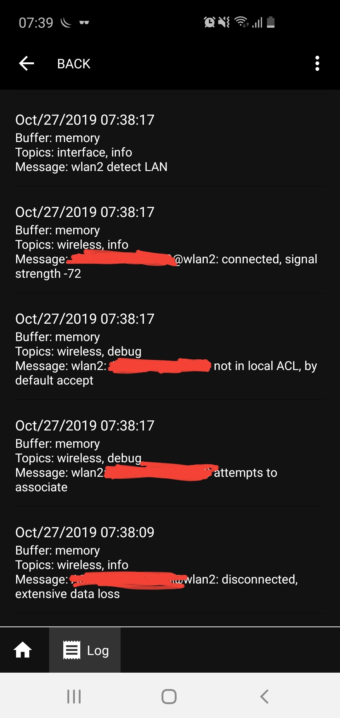

This is what the debug log says when it drops my phone:
Edit: I was watching a 4K movie on my phone and then it dropped two times in less than 4 minutes, now this is appearing on the log:
S10e MAC@wlan2: disconnected, group key exchange timeout
